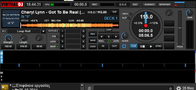

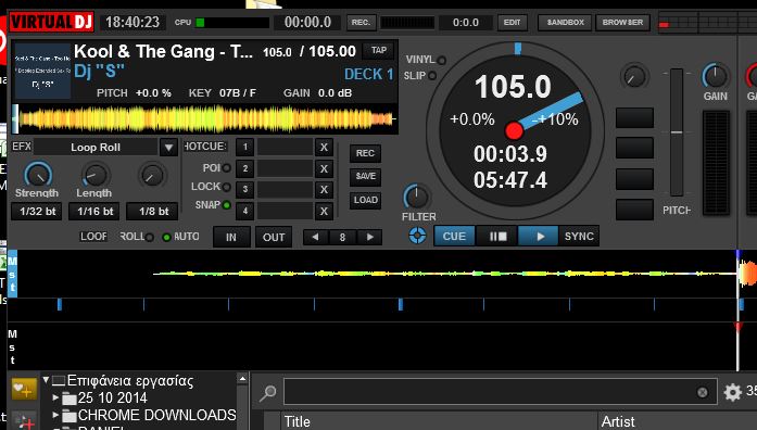

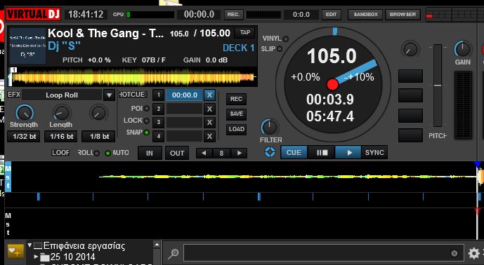

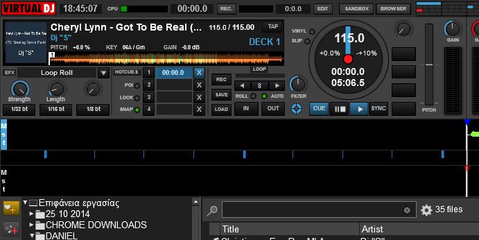

i noticed that when i have hot cues in the track , you can only see the bottom half of the waveform of the track ( because of the overlay with the hot cues numbers.) it is there but you can hardly see it.
is it possible to make the all the wave visible ( like when there is no hot cues) but with the hot cue numbers visible ?
i am attaching 2 pictures , one with no hot cues in the track and one with hot cues in the track so you can see what i mean
and because i am using the small size of the platter ( 2 decks), this is what it looks like
Posted Wed 29 Oct 14 @ 11:43 am
