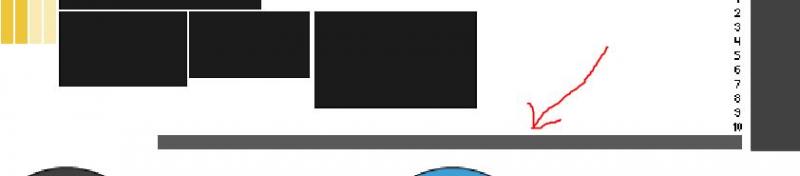

I really dislike this new feature on the hotcues, half of the waveform is hidden!
how can I change this??what in the .xml should I remove/delete for having the full waves with hotcues only??
looking forward
thank you
looking forward
thank you
Posted Thu 30 Oct 14 @ 5:07 pm
Without the black line you can't read the Cuenumbers. Bad contrast.
I will see what can I do in future versions.
For fast self help open the png with gimp and delete the black line under the Cuenumbers. I think you found this one ;)

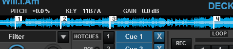

This is what it looks like with the shading removed:
Not too bad really. It would also be possible to have the shading more transparent or even a different colour.
I think it may even be possible to draw that shading as a visual rather than using something from the PNG. Then it could be given variations in shade and colour from within the XML.
Posted Fri 31 Oct 14 @ 6:10 am

is this the line that you mean ?
Posted Sat 01 Nov 14 @ 8:28 am
Yes this is what i mean.
!!!ATTENTION!!!
save the png with transparent background. Use gimp to delete the line.
Posted Sat 01 Nov 14 @ 8:31 am
Yes, just erase the line so it leaves a transparent background. Don't do anything which would move the locations of any other graphics.
Posted Sat 01 Nov 14 @ 8:34 am
ok , did it and looks better !
that was the line
