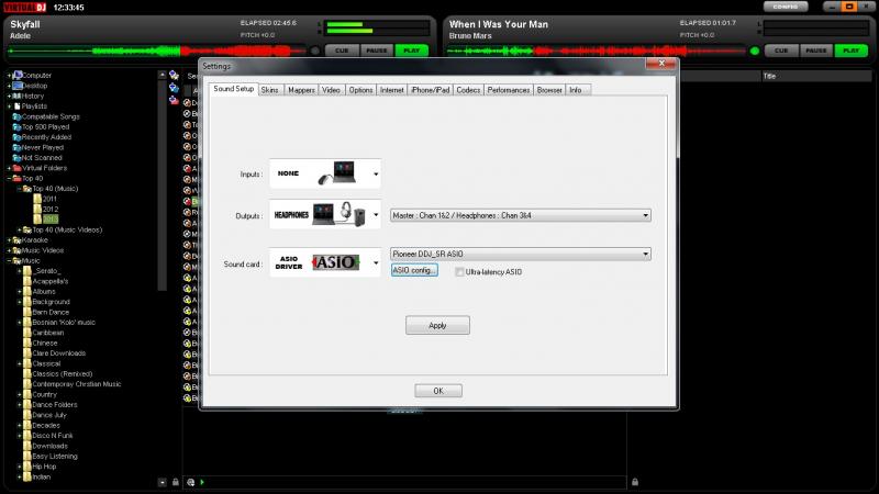

What about sound settings? are these correct?
its ok i found it

Sound Setup as above, should be...
Inputs=None
Outputs=Headphones
Sound Catd=ASIO (Pioneer DDJ-SR ASIO)
(the 3rd icon holds instructions on how the unit is mapped)
Important !!! Make sure the unit is on "Other DJ application" mode and NOT in Serato
Visit this page http://pioneerdj.com/support/product.php?lang=en&p=DDJ-SR&t=272 and make sure your unit's drivers AND firmware are updated.
Inputs=None
Outputs=Headphones
