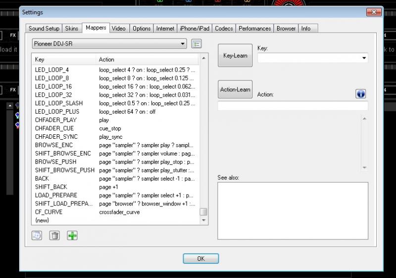

1. Downloaded mapper.
2. Started controller with Shift and Play held down.
3. Pressed left deck keylock.
4. Selected mapper in mappers section in config.

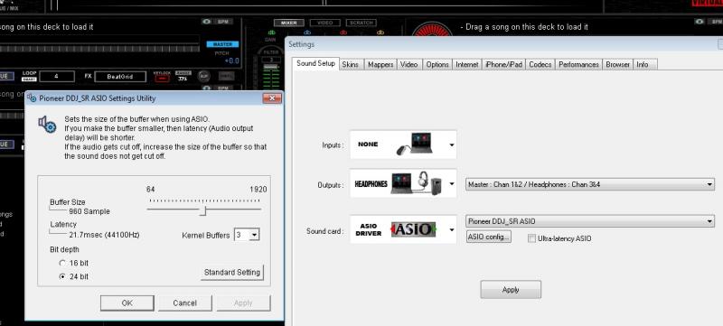

5. Have set sound setup in config.
Midi still doesn't work, nothing.

What exactly do you see in Config -->Mappers tab ? Simple Midi or the unit by its name ? What is yoru Operating system ? Did you try to plug the unit to a USB 2.0 port ?
Posted Mon 21 Apr 14 @ 6:38 am
I am using win 7
I am plugged into a usb 2 port
Posted Mon 21 Apr 14 @ 9:06 am
Did you make sure the unit is on "Other DJ application Mode" ? Please read the manual on how to switch that.
Posted Mon 21 Apr 14 @ 6:12 pm
No 2 & 3 in my original post put the unit into other mode. So yes, I'll ring Pioneer tomorrow had enough now, why could they just have a switch on the back?
