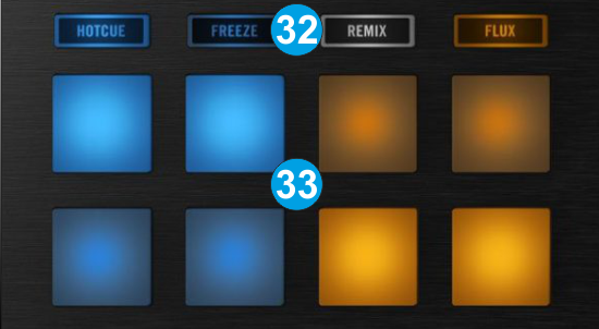

PERFORMANCE PADS
 -  PAD MODE. Press any of the 4 available Pad mode buttons to set the Pads to one of the following modes
 Primary modes :
 [HOTCUE] : Hotcues page
 [FREEZE] : Loop Roll page
 [REMIX] : Sampler page.
 [FLUX] : Stems+FX page
 Secondary modes :
 SHIFT+[HOTCUE] : KeyCue page
 SHIFT+[[FREEZE] : Slicer page
 SHIFT+[REMIX] : BeatJump page
 SHIFT+[FLUX] : Stems page
 All the above pre-assigned pages can be changed. See VirtualDJ Manual
 Note : When a primary mode is selected, hold this mode button down and then use the LOOP Encoder [23] to adjust the 1st Parameter (if available) of the selected Pads page.
-  PADS. The 8 RGB Pads offer different functionality depending on the selected mode.
Read further details about Pads in the VirtualDJ manual
