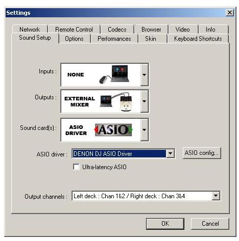

download denon asio drivers here: http://denondj.com/plugin.asp?prod=DN-HD2500
connect device via usb.
install all updates and asio drivers.
launch virtual dj
open settings match your settings to this image
DJ Shahar

Posted Mon 03 Nov 08 @ 5:03 pm

The denondjforums has tips as well. I enabled Ultra, and also placed the Latency on auto per forum posts and the manual. The sound quality was acceptable, but the right deck started to drift on me after about 90 minutes and both sides hung near 4 hours. I don't think I'll use it as an ASIO device/controller again. Next gig will be my RMX and the HD2500 will remain as a standalone solution.

make sure denon knows about this so they can create a patch for it.
perhaps it's because of the "ultra" unclick that, then try it again.
