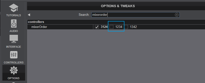

Are you by chance expecting the layout to be (left to right) channel # = deck #?
By default VirtualDJ uses a 3124 deck order structure for all 4-channel mixers it supports (and AFAIK all professional DJ software uses that layout by default).
The manual says it too: https://virtualdj.com/manuals/hardware/pioneer/djma9/mixer.html
So if you are expecting your left and right decks to be channels 1 and 2 on the mixer by default, that would not work (by default deck 2 will go to channel 3 of your mixer and deck 1 will go to channel 2 of your mixer). If you want the layout of 1234, you'll have to change mixerOrder (an option).
As for your history, as long as you play a song audibly for historyDelay number of seconds (another option), it will write the history.

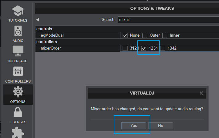

Not sure how you made CH1 and CH2 working on your Decks 1 and 2, but here is the "correct" way..
- First, make sure the DJM-A9 is at Default Decks Assignment (Automatic 1,2,3,4) and you are using the factory default Mapping
- Then switch your MixerOrder setting to 1234
- Once you do this change, VDJ should ask you if you want to apply this change to the audio Setup.
Click to Yes.
Then see if you can properly use CH1 and CH2 with Decks 1,2. CH3 and CH4 will be free to set to USB B for the other DJ.
If not, let us know.
