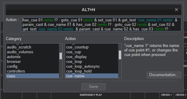

To actually convert [make real hotcue copies] you could use a script like this,
It will go to remix point position, make a hotcue at the same position & give the hotcue the same name as the remix point
try that as a button on a track that you haven't set cue points on.
bad script, corrected in my next reply

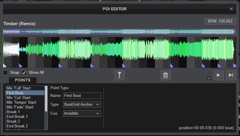

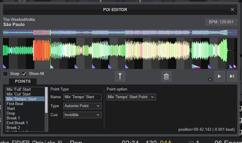

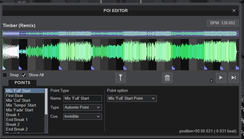

Thank you so much for your help and for the script! I mapped it to a key, but it only created one Hot Cue for me. It seems like most of my points have different names or types than "remix".
I am attaching screenshots of my POI Editor so you can see exactly how these points are named and what their types are. My goal is to automatically convert all these detected points into Hot Cues so I can trigger them from my controller pads.
I really appreciate your time and help with this! Looking forward to your advice on how to tweak the script or about that scroller script you mentioned.

Just to be clear: the script you sent is for "remix points," which I can already manage. However, my main goal is to convert "automix points" into Hot Cues. That is exactly what I need help with.
Virtual DJ generates these "automix points" (like the ones for transitions), and I need a script that targets specifically these and turns them into standard Hot Cues so I can use them on my controller pads. The previous script didn't work for me because it was looking for "remix" instead of "automix."
Could you please provide a version of the script (especially the scroller/batch one) that handles these automix points?
