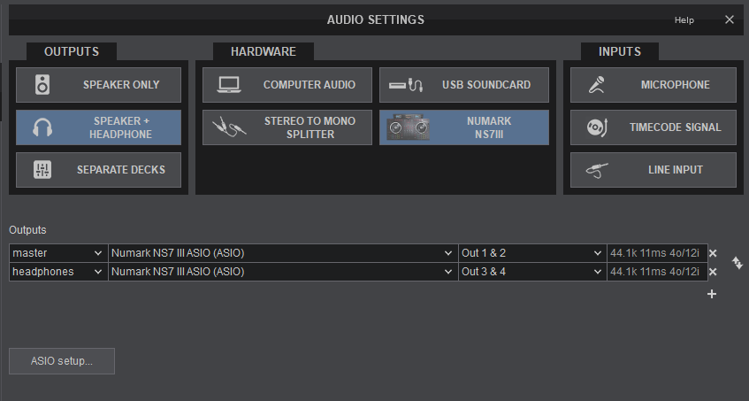

32bit VDJ and my NS7III work flawlessly and as intended, however with the 64bit VDJ the only thing that does not work is the PFL function. In the 32bit version in the audio tab, I see NUMARK NS7III ASIO (ASIO) for both outputs of master and headphones and OUT 1&2 and OUT 3&4. The PFL works as it should.

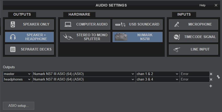

But, In the 64bit version in the AUDIO TAB I see NUMARK NS7III ASIO (64) (ASIO) then chan 1&2 and chan 3&4 (not 'OUT' like in the 32bit version) and error where it should say 44.1k 11ms etc and the PFL does not work at all, all I hear in the headphones is the current track playing out to the master, pressing the pfl buttons on the NS7III do nothing, I've tried a few of the crossfader PFL scripts to no avail.
All drivers are up-to-date, I've even rolled back as many of the 64bit versions to see what may have changed but no joy. Any ideas?, it's almost 11pm, so I'm not expecting answers, and I'll be mostly online all week.

What is your computer's Operating system ? Windows 10, 11 ?
Can you post a screenshot of your VirtualDJ Audio setup with the NS7III connected and the ASIO (64) as the default used sound card ?
Also, with the NS7III connected and without VirtualDJ running, open the windows Sound settings and make sure the NS7III sound card is NOT used as default playback/communication device from your OS.

WINDOWS 10, I've uploaded 3 screenshots, one is to show the dropdown wasapi alternatives which are LINE 1/2 AND LINE 3/4 both of which still do not get the pfl to work. Already check the sound settings and they are fine. the 3rd image (bottom) is of the 32bit version of VDJ and as you can see it works fine with no error

After what seemed weeks of fault-finding I've Finally solved my issue, I uninstalled all the 2012 Microsoft Visual C++ (9 to be precise) and then uninstall both Numark NS7III drivers, restarted my laptop, then reinstalled both Numark drivers while having open the Programs and features folder open to see which version of C++ was being installed (x64 and x86 had same version number of 11.0.51106). Plugging in the NS7III, I found that the 64bit version of VDJ now has the correct Audio OUT and the PFL issue had been sorted and worked as it should like in the 32bit version of VDJ. I've now made a note so when/if this happens again to just repeat the above.
