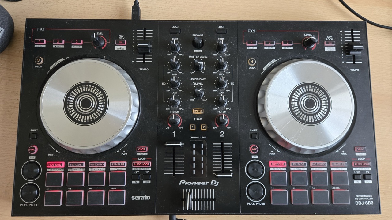

Couldn't find a resolution to my issue in Virtual DJ forum so posting here.
I have connected Pioneer DDJ-SB3 controller to VirtualDJ installed on a new Macbook Pro.
The controller is recognized and the sound is playing via controller's Master output just fine.
All of the button functions also seem to work normally.
But none of the buttons except Hot Cue light up as they should either when pressed/activated.
As shown in the added photo.
