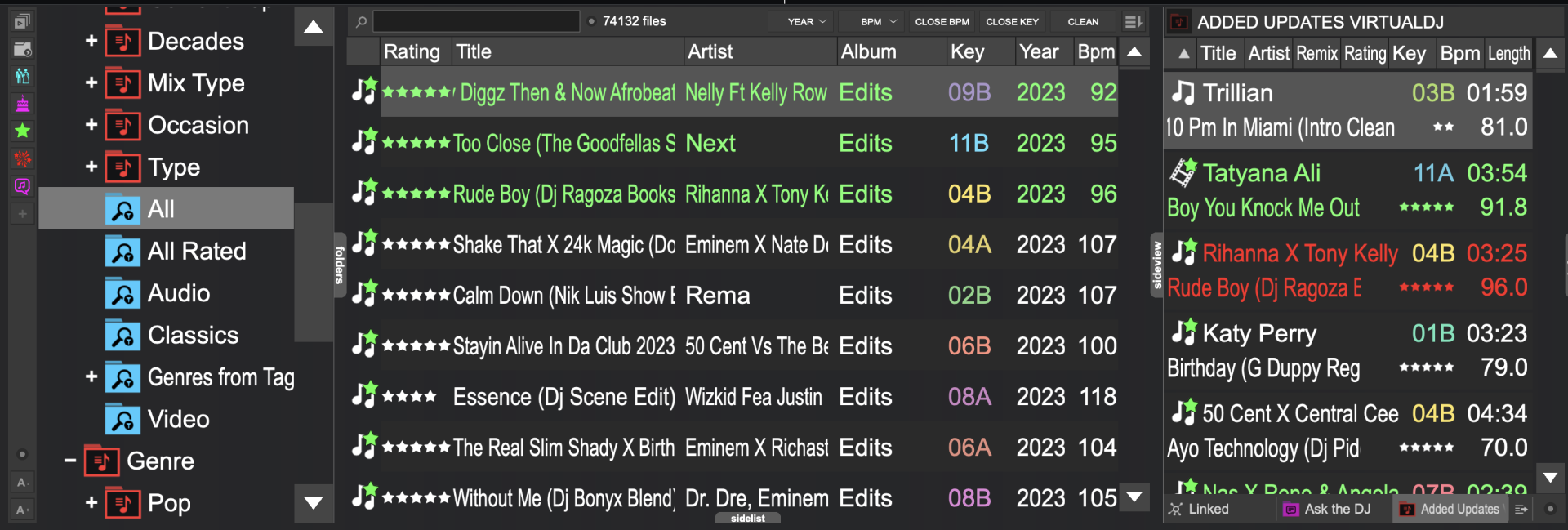

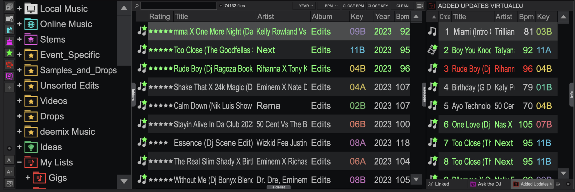

So I quickly hacked in the recommended code for the default skin (performance, full deck view), and I realize that there are some minor visual differences (padding of the fileview top search bar, colors):
Compared to the default browser element:
I've just quickly used the browser class definition on the parent split to try to gain at least color similarity but that didn't work completely. Do you guys quickly know the definitions that need to be modified/added to overcome this?
