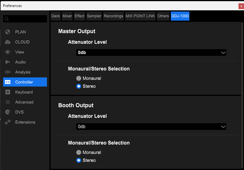

Is this hidden somewhere as my RCA outs (and assuming main outs) are being summed to mono. Normally doesn't effect me as I stream my sets online but have always wondered why when I monitored my RCA outputs it was mono. There nothing that even comes up if you enter "stereo" or "mono" in the options box yet doing a little research, apparently there IS a mono/stereo option for both RCA and MAINS! It's only accessible within Rekordbox and when I toggled them from stereo to mono to stereo IT WORKED!
Can you add this option into VDJ?
Pic shown for reference.

I think this exists already. The DDJ-1000 Hardware Manual lists the following options (plus many others) that appear when the device is connected:
- DDJ1000-masterOutputStereo
- DDJ1000-boothOutputStereo

This is odd as nothing for the DDJ-1000 is coming up in options.

The prefix is "DDJ1000" and you have to connect the DDJ-1000 to see them (they get persisted to the settings.xml)

Thanks - It is connected and working fine for the past 2 years. I'm wondering if the skin I'm using (4 channel) has something to do with those settings missing. "DDJ" brings nothing up - The mystery continues.

ok thanks - problem solved. If you RDC into the laptop running VDJ to remote control it, it kills all the DDJ1000 options.
Case closed lol.
