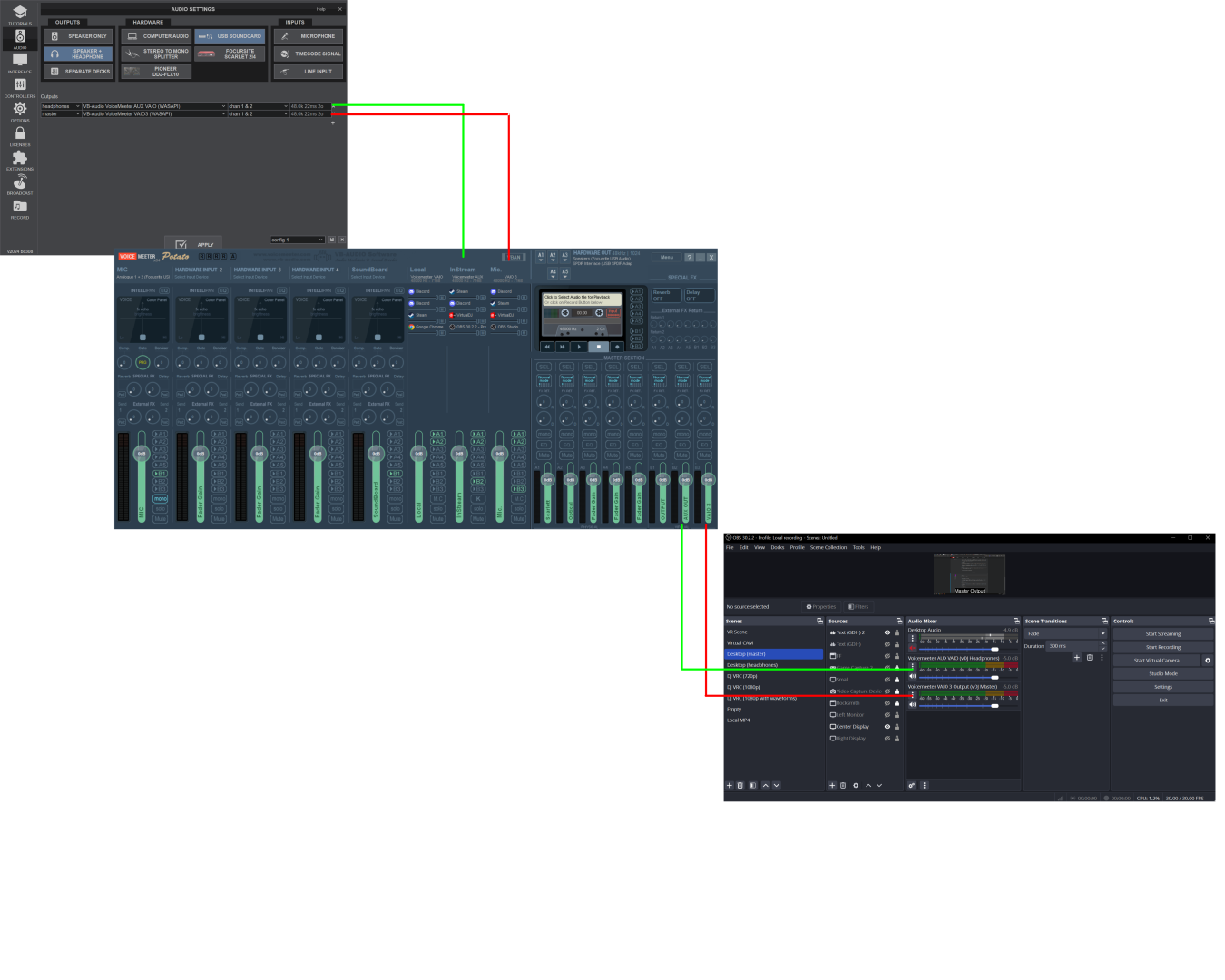

Yesterday bought DDJ-FLX10 (FW is on 1.12), just to turn out that audio routing seems extremely weird/broken with master and headphone cue/master.
A little context i am upgrading from Numark Mixtrack Platinum FX which had perfect audio routing and behaviour see here: https://www.youtube.com/watch?v=_e3LVfFR5fs
Master knob adjusts volume fully & correctly, headphone cue knobs also behave perfectly for any and all audio routing options, as expected!
DDJ-FLX10 on the otherhand seems like master knob does adjust the level (based on master VU meter in vDJ) but not show that audibly no matter what is enabled with any cue button.
Headphone knobs do absolutely nothing with pure software audio routing like this..
see here: https://www.youtube.com/watch?v=PwM1AX29tRI
EDIT1: Master VU meter on the controller also shows nothing with this routing
Example vids have nothing different between them with the only exception being the controller itself.
Am a little at a loss of how to replicate the exact same audio routing... Mayhaps am doing something wrong or anyone has any ideas how to have exact same audio routing as the other controller? i do dj primarily in VR and route headphones to Headset headphones and master to a virtual audio endpoint for streaming, any ideas? Might this be a bug?

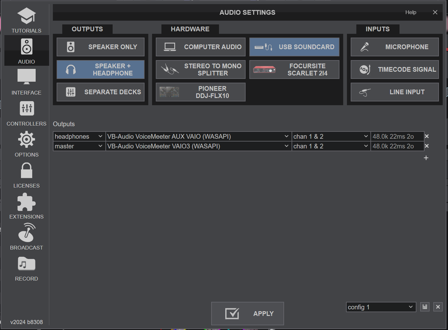

Audio routing for FLX10, the same is being used for the numark one from the vid
Only things connected to the controller are USB-C and power supply
Posted Wed 18 Sep 24 @ 4:02 pm
The image is too small, but I can just make out that you have master and headphones both set to channels 1 & 2. This is wrong. As I suggested earlier, you're not using the default native configuration.
Posted Wed 18 Sep 24 @ 4:05 pm
well i am using a software audio routing and that is for sure not native where speakers & headphones are connected to the unit itself, im trying to do software based routing but that kinda is not behaving with flx10, and it does work with numark one. (no midi info then the knobs on the vDJ would also not change as with the mic knobs, best example i'd say for no midi communication with the unit itself)
changing it to channel 3 & 4 makes it not work at all, since those specific endpoints are stereo and have little to do with the controller itself as far as i can see, native setup would be 3 & 4 which would be correct for that but for this setup 1&2 is def correct, did try various configs with VR headset too to no avail, at this point pretty sure it has to do something with how vDJ handles audio when it sees this controller...
Added a bigger image for audio config window

I don't really understand what you're trying to do with the setup.
Your first post made no mention of Voicemeeter or (presumably) OBS, just that the audio wasn't working correctly. We can only respond to the information provided, so if you don't mention something, we go round in circles.
What exactly is the purpose of Voicemeeter here, and why are you sending the master and the headphone signal to that and not the FLX10 interface? Then both master and headphones go from Voicemeeter into OBS? Why?
If you're broadcasting, you can do that directly from VDJ.

Sorry, shoulda gave more info. Purpose of the voicemeeter is for streaming while in VR, the way i am streaming doesn't really work right out of vDJ itself via broadcasting. And yes i did try.
Videos themselves do show how both controllers work in different ways when in reality they should behave the same with this setup, because controller itself does only send and receive MIDI and nothing more (with this setup) all while audio itself is not the same (and that happens on the computer only), master knob does nothing, headphone mix and level does nothing with FLX10 as if the audio routing is broken with it when audio is being processed only on the computer (vDJ) in this case.
With a traditional default setup it works and master cue does what it suposed to do but any deviation from default setup (speakers and headphones hooked to FLX10) seems like is not possible at the moment which is weird, even more so when MIXXX works as expected 🤔
The whole flow is i get into VR put the HMD on and enable visual passthrough then i can see the controller itself and vDJ itself via screen overlays, audio routing is important since i use the VR headset headphones as cue/master preview on one voicemeeter track and the other one goes to OBS as live/master (OBS in my case combines visuals from magic music visualiser, webcam and audio)
A lil off-topic but audio routing in MIXXX with both controllers works identically, and in the way like vDJ works with numark mixtrack platinum fx, just tested it for sanity reasons, personally prefer vDJ over anything else tho 😅
100% sure vDJ audio routing misbehaves with FLX10... If any Devs could take a look at it or explain some stuff how vDJ works would be a lot appreciated...
P.S. i do have decent HW & SW understanding being a programmer, and it really does point toward vDJ being buggy/weird as soon as it sees FLX10 connected...
