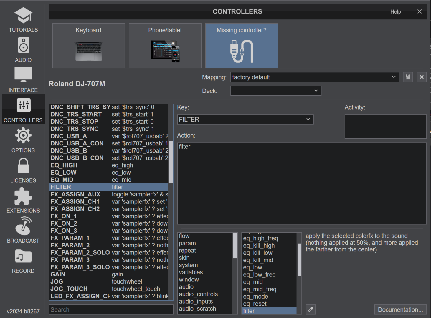

kradcliffe wrote :
Have a look at your mapping to see if filter is set correctly.
Looks the same:
/Users/ronaldlavoie/Desktop/Screenshot 2024-07-29 at 17.44.41.png
Posted Mon 29 Jul 24 @ 9:48 pm
