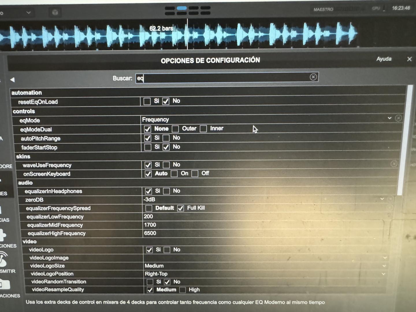

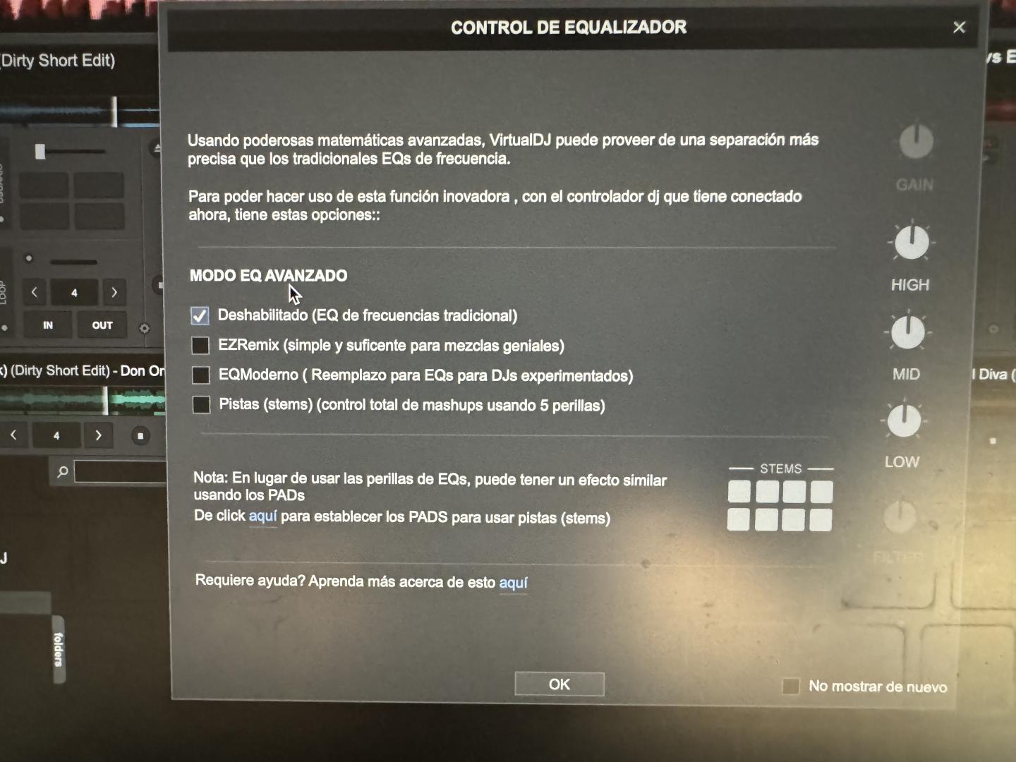

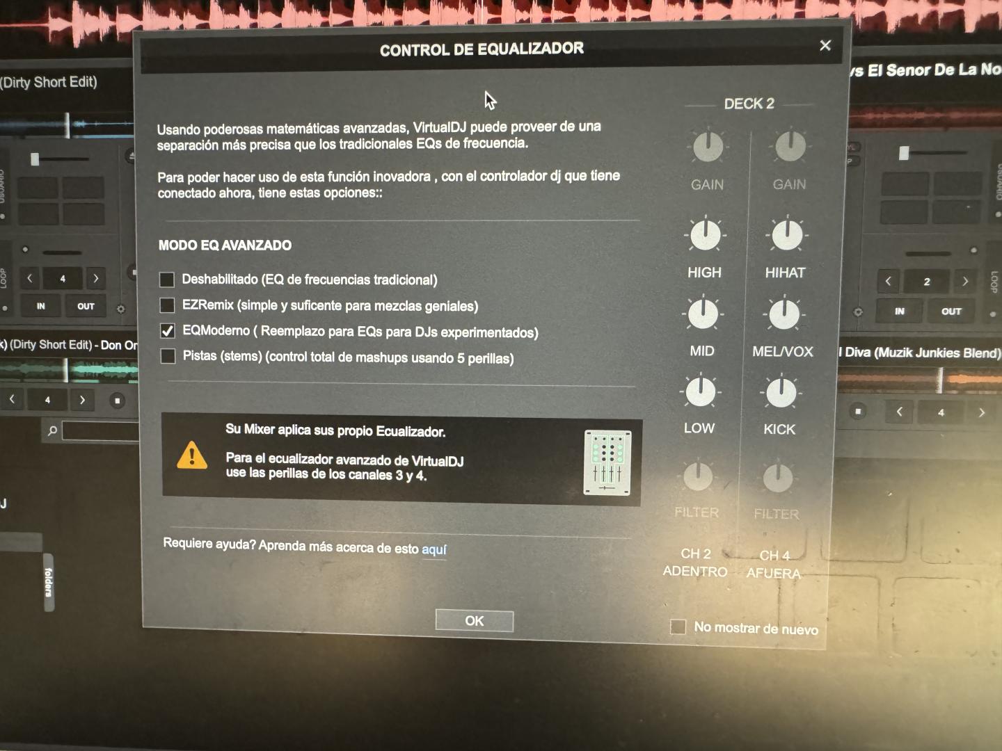

Looks like eqModeDual is not set to 'None', since you have both outer and inner channels controlling the same deck?
Posted Fri 05 Jul 24 @ 11:35 am
I attached the configuration, as I said before, the initial set up is "eqModeDUal= None" and "eqMode= Frequency" when I press Shift+PFL automatically EQModern is activated on channels 3 and 4, and classic EQ is not working, you can see how it is moving classic knobs on interface if you move the knobs (physical) on channel 1 or 2 but this is not affecting any frequency, if I move the physical knobs on channels 3 and 4, I can see how eqStems are moving on the interface and eqStems works as expected but this is not happening with classics ones. After that if I push shift+PFL again, and nothing happens, I cannot go back to "eqMode= Frequency".
For me it is ok if it works as Serato do right now, pressing Shift+PFL, but I cannot get to make it work like Serato with any configuration, I can assure you that I tried every configuration available, I'm telecommunication engineer, with this I mean that I have the ability to configure the system as you are suggesting.
Thanks so much for your support.

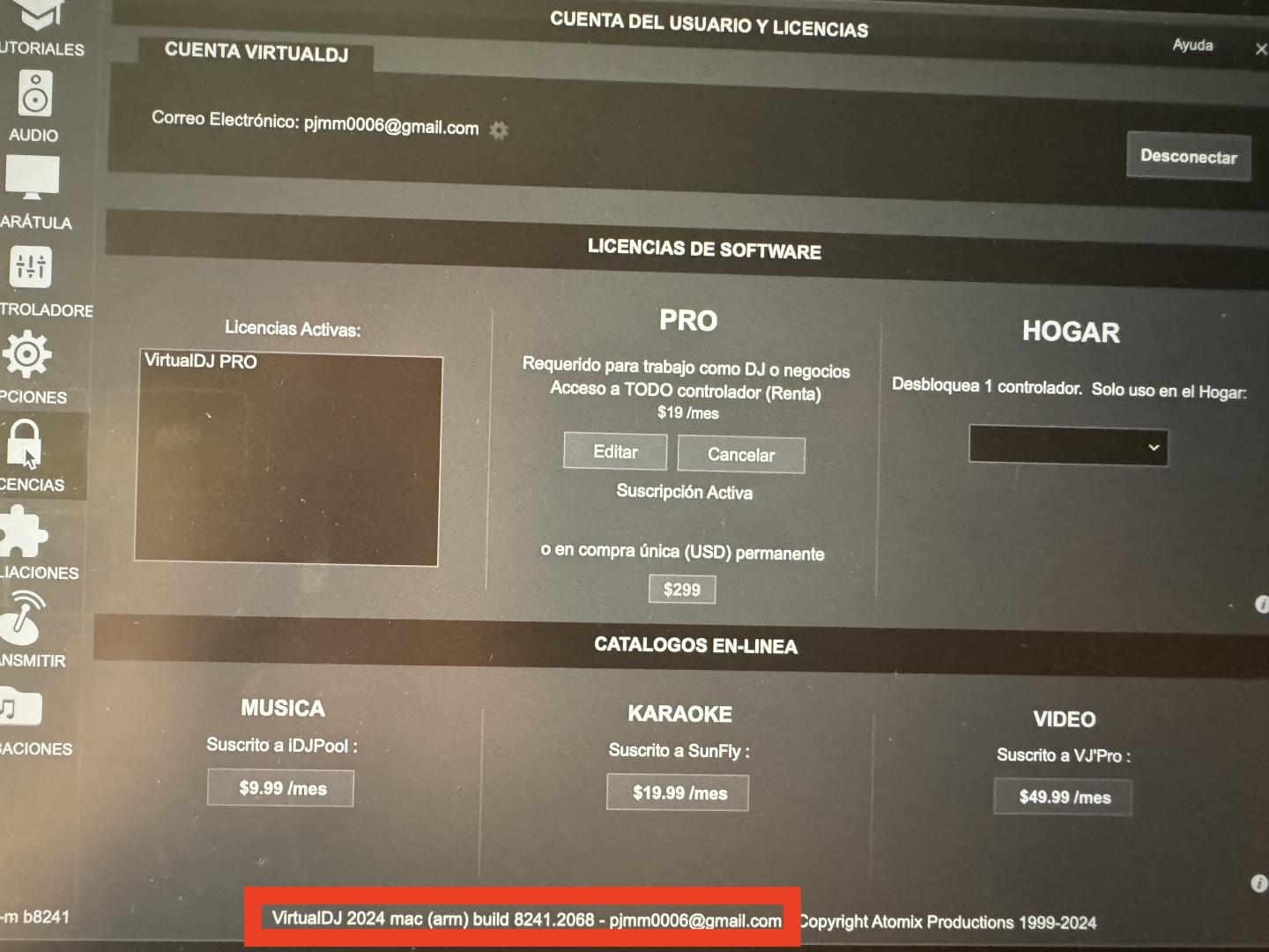

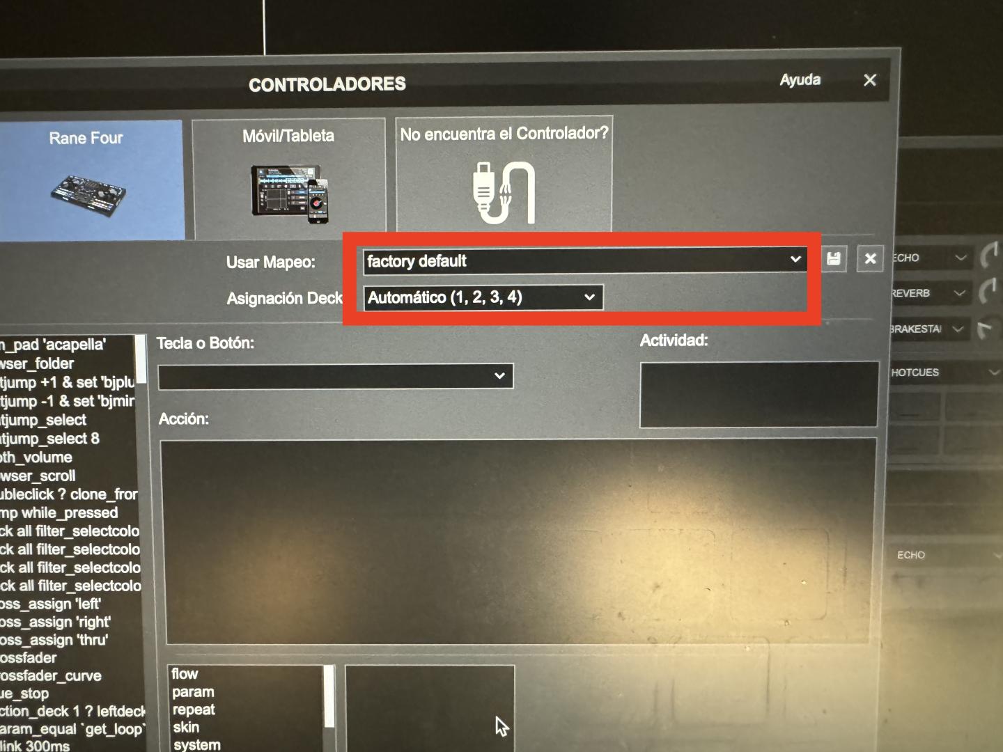

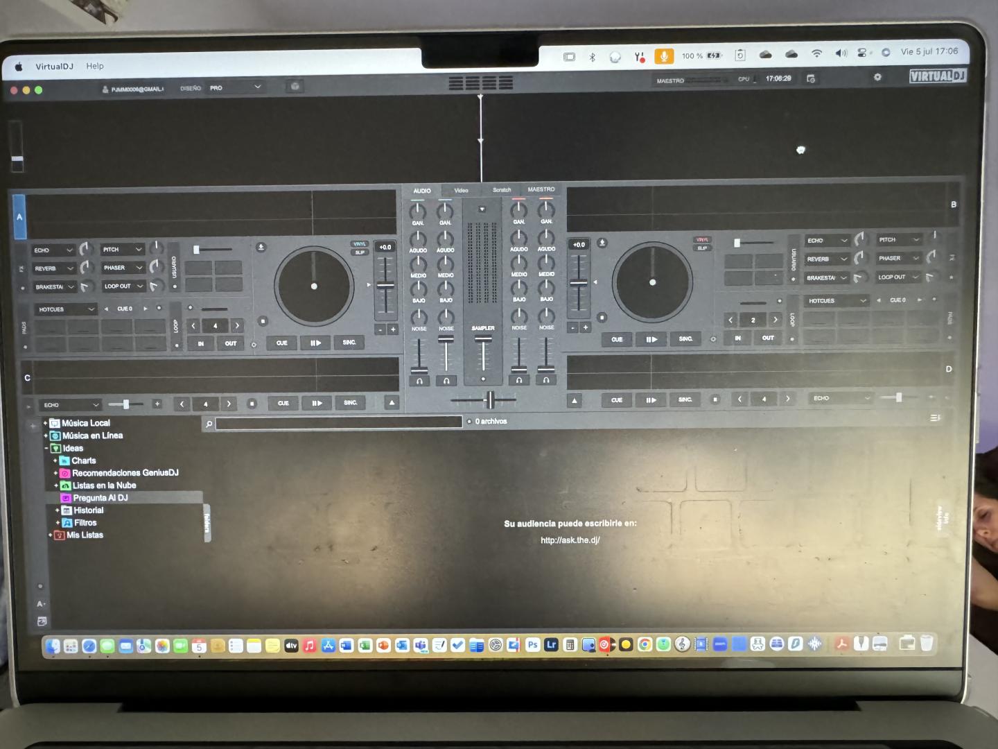

And you are using the factory default Mapping ?
Also, please confirm from Settings->LICENSES tab - at the very bottom - you get VirtualDJ build 8241.2068
Can you please test with the 4 Decks layout skin and confirm that using SHIFT+PFL is toggling between Frequency and Stems PER Channel on the skin ?
Posted Fri 05 Jul 24 @ 3:03 pm
Yes, I'm using factory default mapping, you can see a screenshot attached.
The version I have running is 8241.2068, you can check it attached.
I just tested the 4 Decks layout skin and happened the same. I attached screenshots of this. You will see a initial configuration as Disable (classic EQ) and another screenshot after press Shift+PFL and you will see that it changed to EQModern, after that, anything is working as expected, because in this configuration "4 Decks layout skin", I cannot use EQStem and Classic EQ are not working... I think something is not mapped properly.
