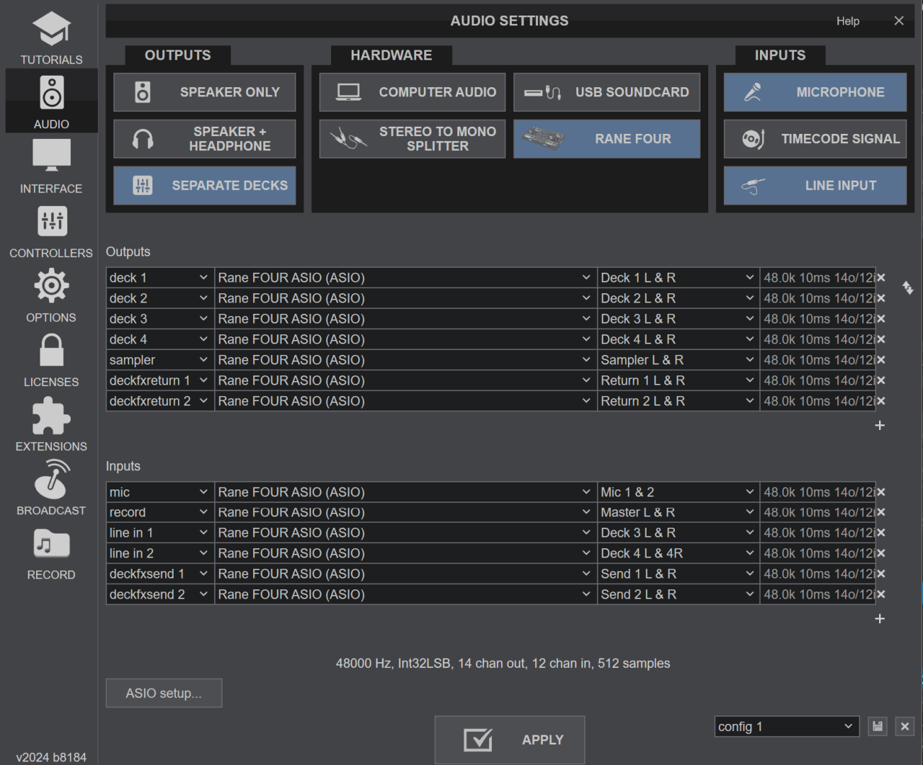

Here is my audio setup if that matters
Posted Sat 29 Jun 24 @ 7:46 pm
