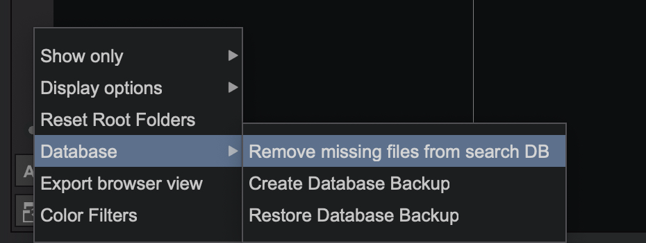

You can check "Database" -> "Remove missing files from search DB" (dot in bottom left corner)
I noticed that it works with Tidal tracks, so maybe it'll remove other online tracks as well.

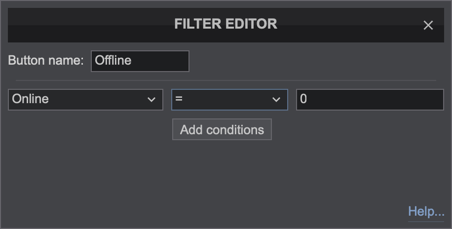

The other option is quick filter that displays tracks that are not online (Online = 0)

I tried that, even after signing out of Soundcloud, and it didn't seem to make a difference.
That actually worked! Thank you.

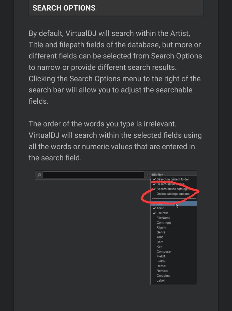

Also, if applicable, you might want to check if your search includes online catalogues and disable that:

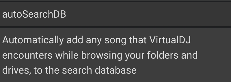

You might also try disabling the autoSearchDB option (althought the description seems to imply local files)
Those two suggestions are aiming to stop the songs from being added to the search database unless you explicitly decide to add them. The quick filter filters them out given they are already there.
