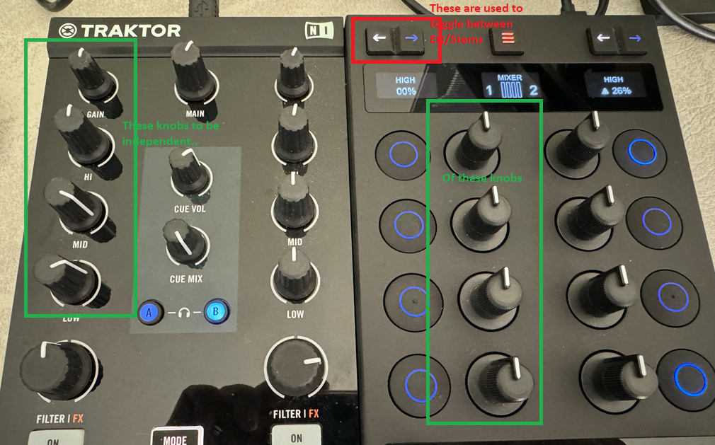

I have both the Z1 and the X1 mk3 and they work well for switching between EQ and Stems, but what I would like to happen
- The Z1 treble/mid/low knobs to keep doing EQ,
- The X1 mk3 knobs to be able to switch between stems and effects/mixer like they do now
- The X1 mk3 switching between mixer/stems/effects to have no bearing on what the Z1 knobs do
At the moment if switch it on the X1 mk3 then the knobs on the Z1 also change. So if the X1 is pointing to Stems, then the Z1 changes to stems as well. I'm using the EZRemix functionality with the standard VDJ setup for the Z1 and X1 mk3, but maybe I need to use the default (EQ) and somehow map the X1 mk3 separately. Any ideas?

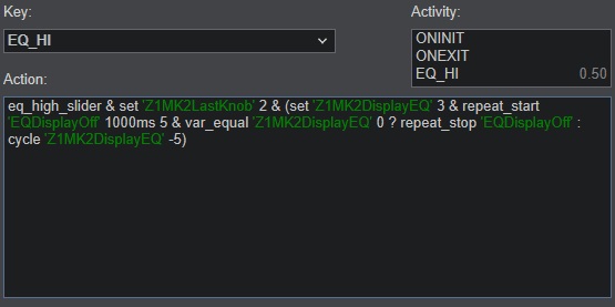

Am I adjusting the wrong thing here? The only mention of high_eq is "high_eq_slider", and changing that to "high_eq_freq" doesn't seem to have any effect. The Z1 still switches modes when the X1 does. Is it not possible to disable that functionality and have them both be able to switch modes independently, as they do in Traktor Pro?
Posted Sat 06 Dec 25 @ 12:00 am
Are you sure you used the correct names ?
It should be eq_high_freq
The rest of the script is there just in order to control what the screen shows
Posted Sat 06 Dec 25 @ 5:46 pm
What I mean is that I didn't see "eq_high" in the default mapping. Mine had "eq_high_slider" and appending that to "eq_high_freq" didn't seem to do the trick.
