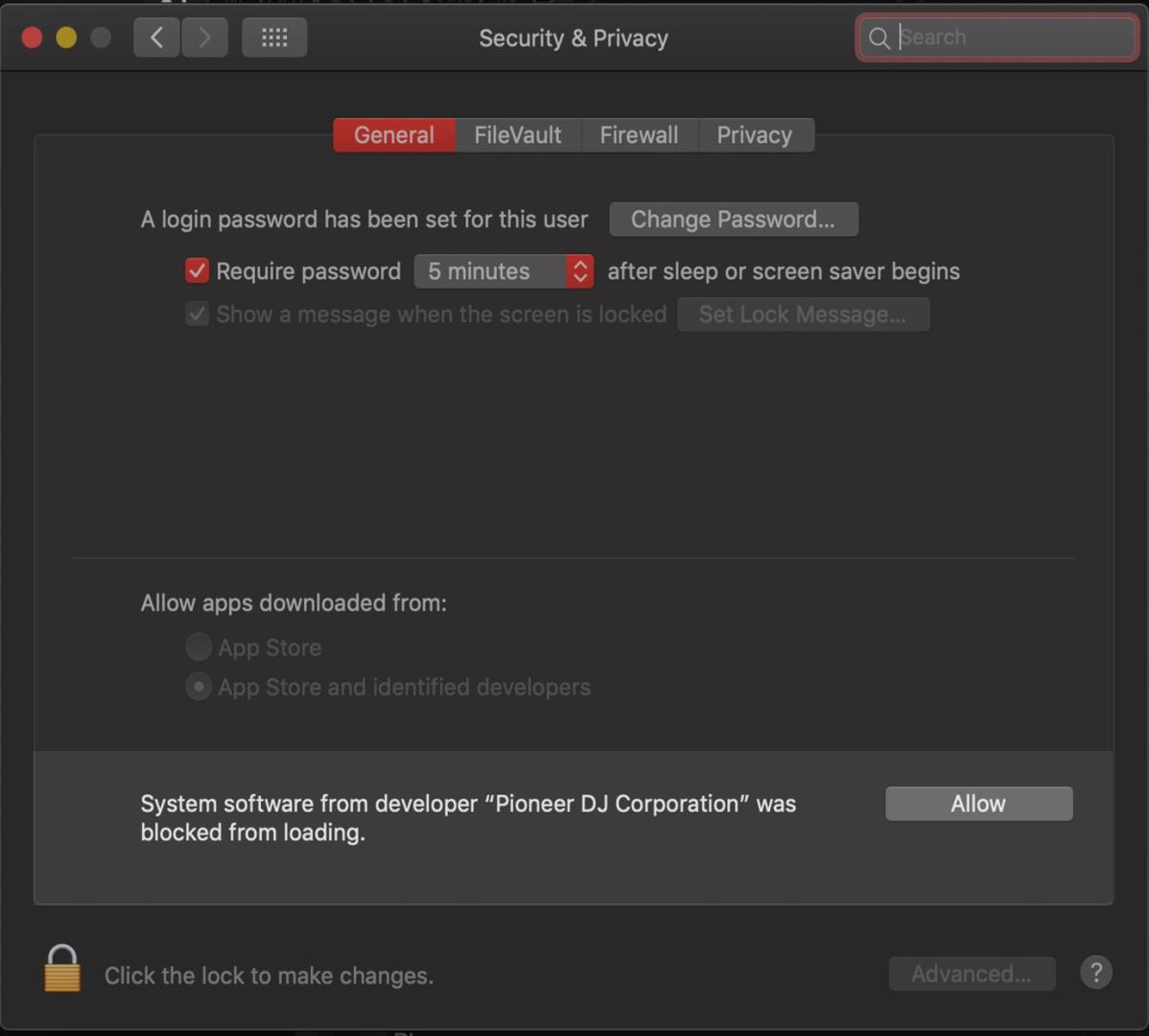

Mac is notorious for blocking drivers. Simply unblock the driver, and all should be ok

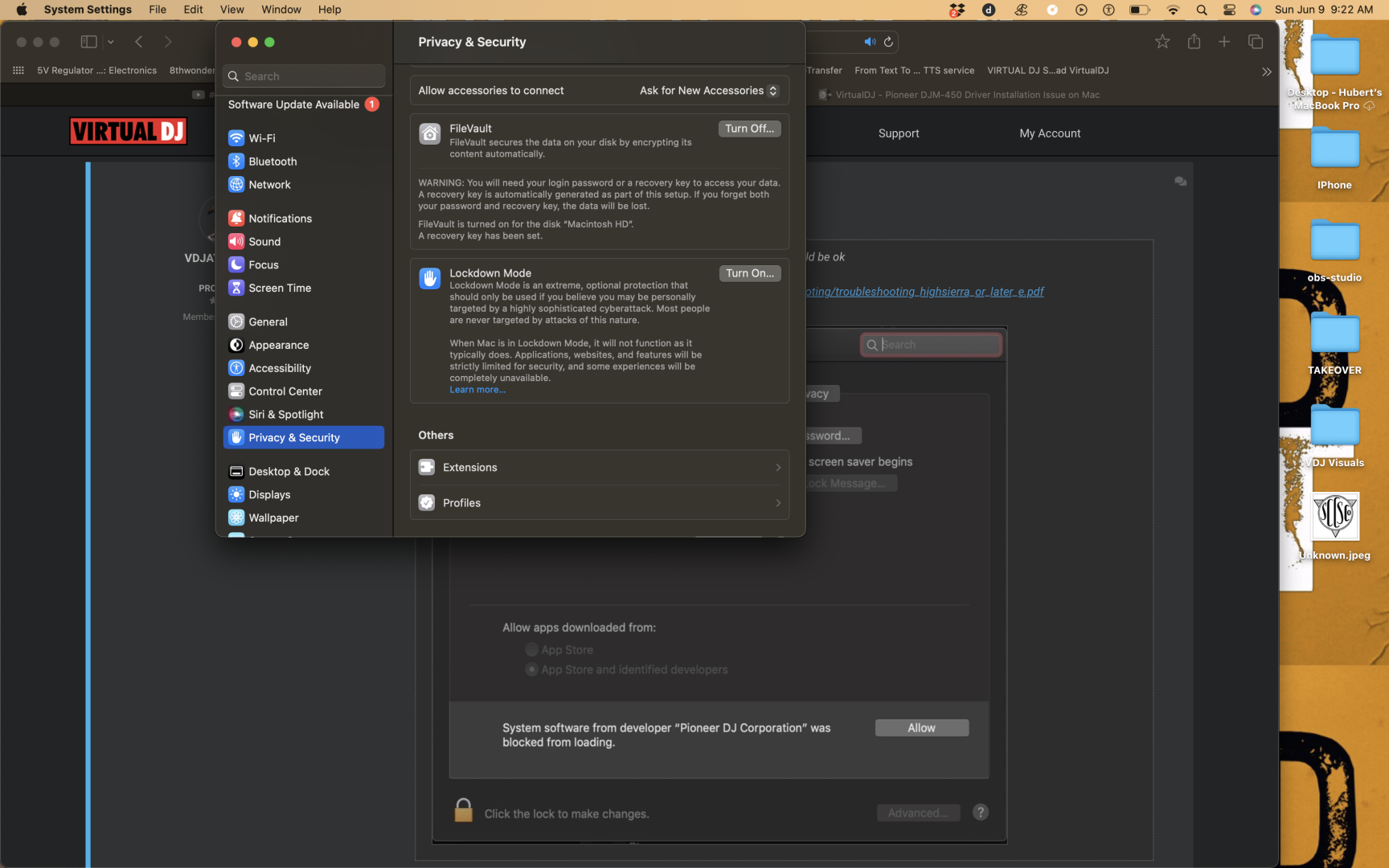

So this screen or menu isn't in the current version of Mac OS. (They have since redesigned this part of the settings menu) So I don't know where to find what Pioneer is showing in its images as they are now out of date. Does anyone else know how to allow Pioneer driver access on Mac OS Sonoma 14.5?

Its still under the same tab you just have to scroll down

Found it?
Just look at the tabs instead like said above ;-)

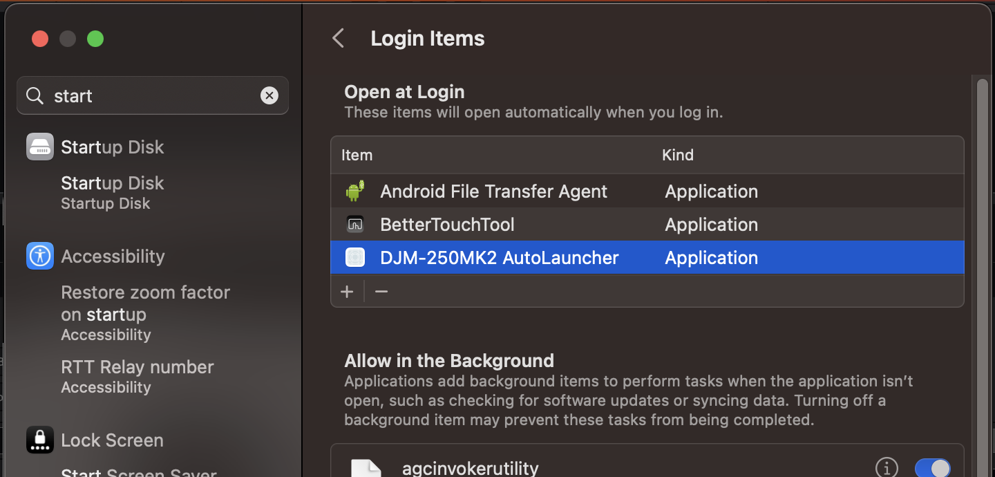

Also worth noting is that for me there is an item in System settings > Login items showing that the Pioneer AutoLauncher app should start at login.
So, you might want to try restarting your device and see the drivers are found after startup. Still a frustrating issue for me though and if anyone could shed further light on this it would be much appreciated.
