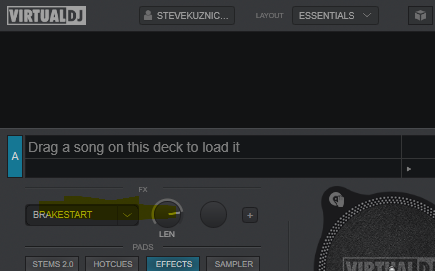

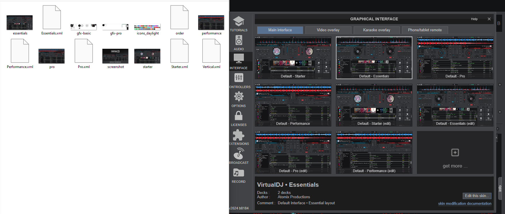

Can someone help me figure out how to edit/choose the buttons on my controller for the effects I want from the skin? PICS below. "Effects on controller mapped to Essential layout on skin"
E.g. Button 1 - Brakestart, 2 - Echo Fad, 3 - reverb instead..instead of the default

Where? Please give more screenshots, and details to help guide. I am new to this. Thank you so much.

You don't need to edit the skin!
Simply add the code onto one of the existing custom buttons (on the Pro skin, not the Essential skin)
