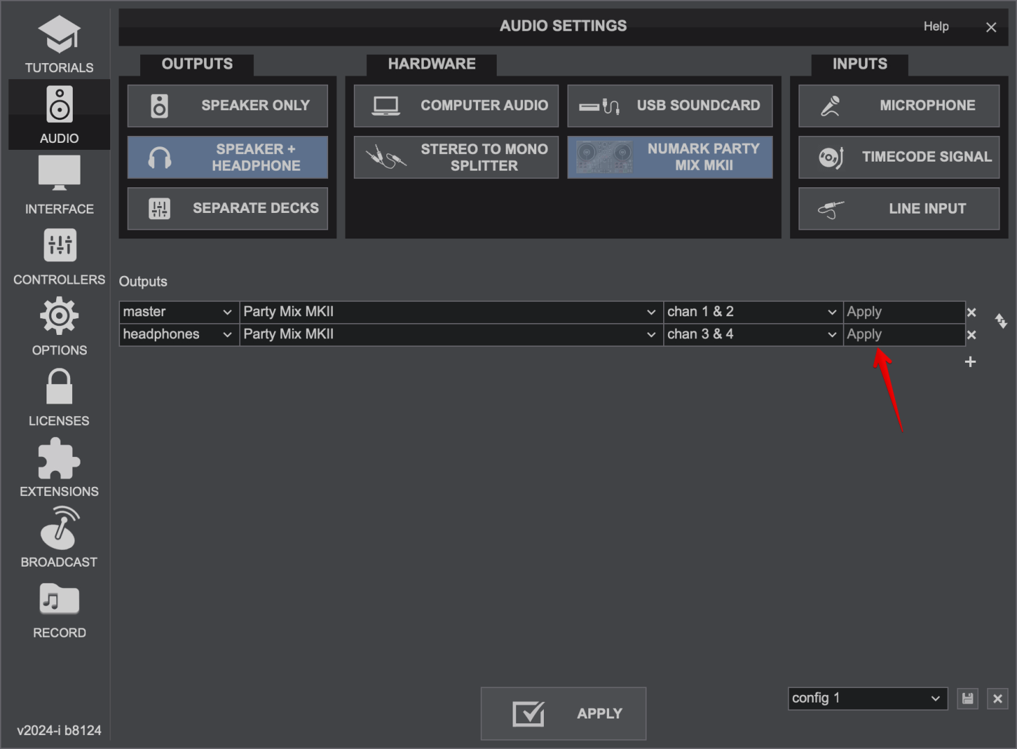

It happened to me only few times over the years, but for glitches with no audio I change to OUTPUTS: SPEAKER ONLY, HARDWARE: COMPUTER AUDIO (+ click APPLY), then back OUTPUT: SPEAKER + HEADPHONE, HARDWARE: NUMARK PARTY MIX MKII (+ click APPLY), and it starts working again. Remember to click APPLY when changing AUDIO settings.
Let me know if that helped for your case.

One more note: if you see Apply in the last column (marked with red arrow on screenshot) that means that you still need to click APPLY button at the bottom to make those settings work.
