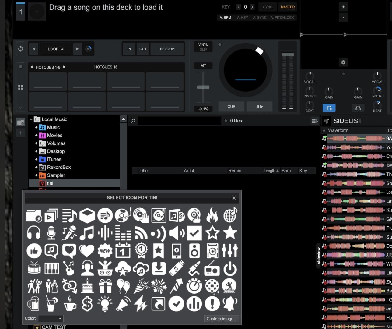

This is driving me crazy since re-installing VDJ there os no option to create a new playlist in "Local Music" I'm using the most up to date Vanced skin when changing skins there still is no option to create a new playlist. When I click the
"+" button on the left side of the files all I get is the option to give current playlists a new icon.

          playlists are now mostly supposed to be in the MyLists folder.
To create a new one, just click on the text "click here to create a list" that is shown instead of files when you select the MyLists folder. (or right-click and select "add list").
If you really want to keep your lists under local music, you can easily just drag and drop them from MyLists to LocalMusic
