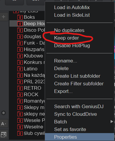

Hello. With the new update the order in browser for files with the bpm standard is gone. The new staff is to make new orders for the lists but it is very difficult to keep the order only with the bpm for all files! Can you please tell me how can I ll use the previous setting just to keep the order always with bpm without fixing anytime I change file??
Thank you in advance.

Hmmm....
For me it only changes if I click another column header - other than that the ordering for BPM (or any other column) stays between switching of lists, folders and even between VDJ sessions
UNLESS I enable the new "Keep order" feature on lists
That enables each list to have it's own columns and saved ordering
But that doesn't happen by accident. That's something you actively have to choose for a list

Thank you Klaus. The point is that I've tried the new keep order effect but doesn't work. Without changing columns, the bpm column needs to set every time I change file list. I've checked the options and have nothing about it. Do you have something in mind??

Keep Order on the list should be off if you want to see the list sorted by another field.
keepSortOrder in options should be set to Yes to remember that BPM was selected

No my friend it doesn't work and the version is b8079
Posted Fri 05 Apr 24 @ 3:38 pm
Any column I select in a list,when I change list not keeping the order!!!
Posted Fri 05 Apr 24 @ 3:43 pm
I found it! You must turn off list by list the keep order choice!! It's very annoying!!!! Why we must do this??!?
Thanx anyway!!!!
Greetings from Greece!!!
Thanx anyway!!!!
Posted Fri 05 Apr 24 @ 3:54 pm

uncheck keep order on all lists
Posted Mon 06 May 24 @ 8:11 am
Well, it's a setting on the list, so it makes sense :)
Posted Mon 06 May 24 @ 8:20 am
