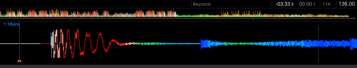

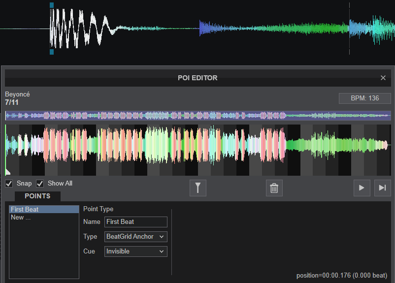

Hello,
When using CDJ Export, some beat grids are shifted early in Rekordbox compared to how they are set in VDJ. I saw the same shift in Rekordbox 5, 6, and Mixxx (which can read CDJ USB exports). I observed the issue with all 3 cdjExportCompatibility settings (400/2000/2000nexus). My methodology was starting with a blank FAT32 drive on Windows, open VirtualDJ, create a playlist, drag in a track with existing beat grids, wait until writing USB was complete, close VirtualDJ, open Rekordbox, load track.
The issue seems partially dependent on filetype. All of the .aiff files I tested (which are converted to .m4a by VDJ when exporting) had grids shifted early, some .m4a files had shifts, and none of the handful of .mp3 files I tested had shifts.
I think it could relate to this issue here: https://github.com/digital-dj-tools/dj-data-converter/issues/3
Any assistance is appreciated. Thank you.
