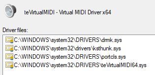

previous skin sent is set up for the virtual device angle, I've a mapping and definition already wrote, I just need the driver name of the virtual midi cable.

Thanks Loco, do you mean the driver for the lighting console of mine ?
Or:
https://www.tobias-erichsen.de/software/loopmidi.html
Or:
Posted Mon 08 Jan 24 @ 10:19 am
loopmidi
