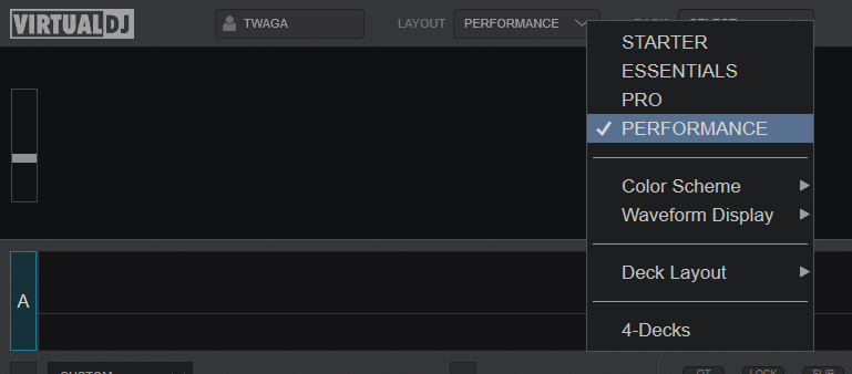

There is no "WINDOW" menu item. If I need to install something, can you tell me the download URL?
Posted 3 days ago @ 3:57 pm
@twaga
you need my skin and mapping to get the window. It's a few beers for it, the original commissioner & I worked for 3 weeks to make the thing he wanted, and he paid a lot [a couple of hundred US$ in 2022].
I've since developed it further from feedback [about 18 people], going rate now is ¥10,000 , minor tweaks are free, non-trivial changes are costed by time but fair.
I don't do subscription, it's beer money not a wage. So if an update breaks something [which hasn't happened yet in 3 years] I'll fix it, I might ask for a 2-3$ donation, but 20 people * $3 that pays for my couple of hours.
Posted 3 days ago @ 9:16 pm
