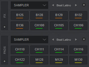

I was just playing around with the Pro skin (b7827) and I noticed something strange with the sampler...
With the same panel options ticked on both decks, bringing up the sampler banks with 16 samples, on the left side I see all 16 - the first 8 in the FX area, and the second 8 below, in the pads area.

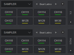

However, on the right (deck) side, I only see the 2nd bank of 8 repeated.

Can anyone else please confirm that it's not just some quirk on my system(s)?
I've had a look at the skin code, and not found anything odd. I've swapped to different skins and it's still the same (so unlikely to be skin code).
I've gone back as far as I can with old builds that are still available, without success. I also tried my old 32 bit VDJ which I've not updated and it's the same.

Indeed, the second deck will always start from sample 8 if there are more than 8 samples.
Currently the pads are all individually mapped, so it's a bit tricky to make the right side aware that the left side is showing 16 samples instead of 8.
I can probably fix it if sixteenPadsMode option is set to Yes, and alternatively you could also modify the sampler pad page to use sampler_pad 1 "4x4x2" instead of sampler_pad 1 "auto"
Posted Thu 30 Nov 23 @ 12:18 pm
It's confusing because when set to 8 pads per side, it makes sense to have access to 9-16 on the right, as controllers generally have 8 pads per side - but when switching the skin to show 16 pads per side, the left side shows all 16 but the right side doesn't do the same - it only shows 8 repeated.

Thank you for the fix in the latest update @Adion.
