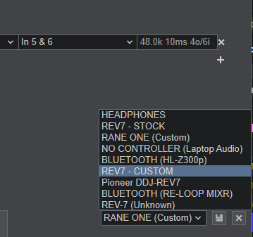

Rudy I know exactly what your talking about BRO!. You need an answer..
STEP 1 - DID YOU Install & RUN The Pioneer Rev-7 Audio Driver? If Not You will need it 1st
Before you run VDJ.

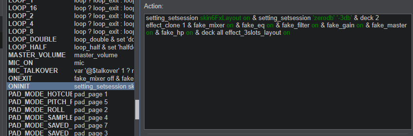

1) CREATE & SAVE a New REV-7 (Custom)
2) GO INTO YOUR MAPPING, and Look for ONINIT
3) SET YOUR SCRIPT FOR ONINIT (When Loaded Do This or That)
