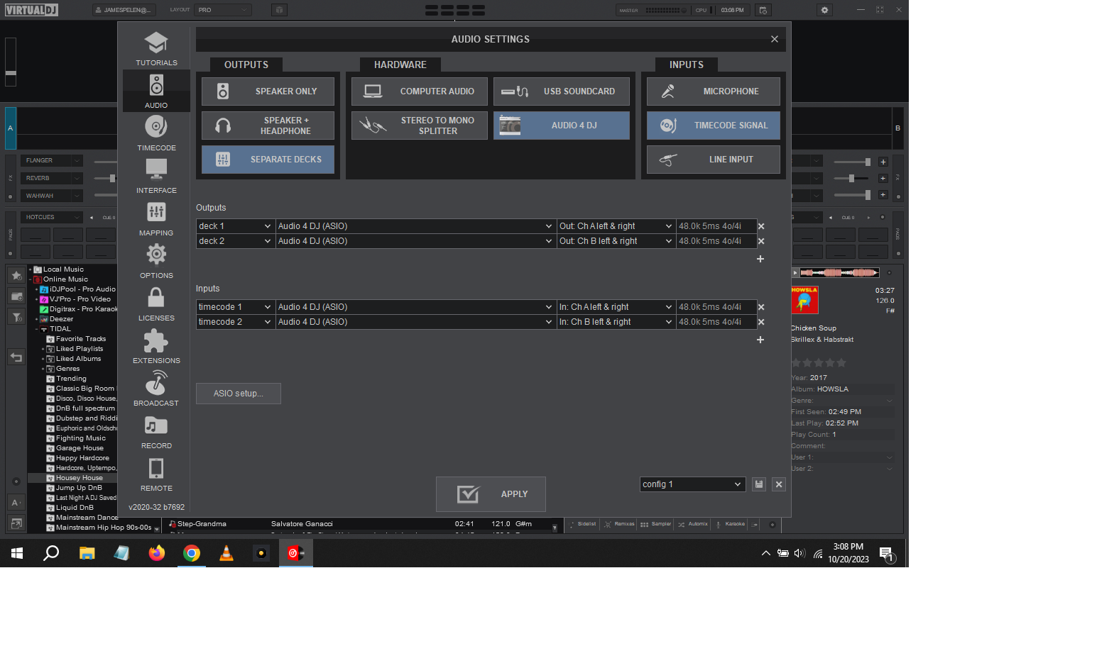

I have the 32 bit version of VDJ installed on a Lenovo x201 laptop running Windows 10. Yes, this is indeed a 32 bit OS due to the age of the laptop. I have the NI Audio 4 DJ soundcard connected to the laptop directly with a USB cable and in the settings utility, I have the soundcard set to Vinyl Control (which illuminates both the line and phono LEDs on the soundcard).
From here, I have a 7 inch Serato vinyl (side A) on a Numark PT01 Scratch and the output of that is going into the inputs for A on the soundcard. The Audio Settings are below.
Neither ASIO nor WASAPI are resulting in anything showing up in the timecode scope. There was a point where I was getting a big square but after a Windows crash, I cannot get the green circle to show up in any capacity. I tried changing the selection of the timecode type to others to see if I get even something distorted but still nothing. Any help would be greatly appreciated.

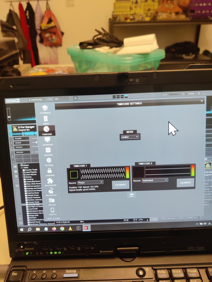

Could you post a picture of the calibration?
Posted Sun 22 Oct 23 @ 2:39 am
Here is a photo.

As you can see from the pictures in the manual, the graphic on the left is supposed to be a circle, and the wave should look like a sine wave with some peaks higher than others.
https://www.virtualdj.com/manuals/virtualdj/settings/audiosetup/timecode.html
On your setup the peaks look flattened, so probably the input is clipping because it is too loud.
See if the Audio 4 has a control panel where you can lower the input volume until the calibration shows like a circle.

That did it! I just had to change the input mode on the Audio 4 DJ from Phono to Line which got rid of the clipping issue and works as expected when selecting Serato as the timecode type. My issue was not realizing this turntable has its own built in preamp. Thank you so much for the help!
