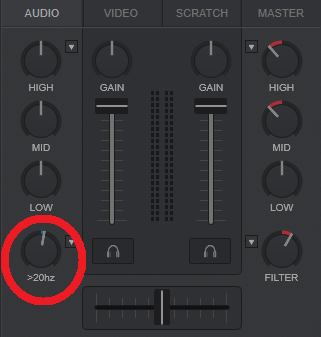

I'm getting older and I can't see as well as I used to, which is why I'm having trouble seeing information in small font, but I don't know how to increase the font size, I'm posting an image and marking where I'd like to increase the font size.
I'm using the default pro skin, probably i need to edit pro.xml but dunno where.

not so easy to do just the one, but at line 923 you'll find the definition, change the height & font size [I upped both by 4]
<textzone visibility="true">
<pos x="[TEXTLEFT]" y="+40"/>
<size width="[TEXTWIDTH]" height="18"/>
<text fontsize="14" color="textoff2" align="center" important="true"/>
</textzone>
if you don't have line numbers search for
define class="knob"
that's the definition you'll find the text zone in

I sent him a link, not sure what happens in the case of a default.zip & a skin update, I don't think it would copy over.
Posted Thu 21 Sep 23 @ 10:01 pm
@locodog your files worked, maybe its beacuse its zipped? my delaut skin is in a folder, default installation,.
Did I done something wrong to have one reply moderated? If yes i'm sorry.
Thanks @locodog you helped me a lot, even if a update overwrite the skin you sent me, i just put again in the folder, or just rename the skin so the update dont change this skin with bigger fonts.

you can leave the zip as is, it's renamed already at zip level, not sure what went wrong your end, in your pic np++ is unsaved?
skins don't have to be zipped, my forever WIP skin hasn't been zipped in years and I use it daily

I saved the changes, but I dont know why dont worked, but you files saves my eyes from hurting, thanks a lot....

It's a skin, the o/s shouldn't matter, but I've already given the instructions to make it yourself in my first reply.
