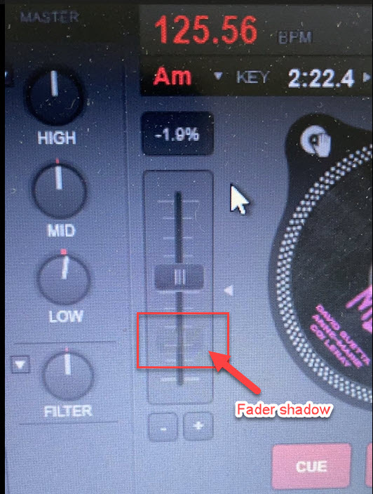

I have a question about tempo changes via the fader on the Rev7. Changes to the fader first have no effect at all on the speed of the track. Only after very large changes on fader, the software suddenly reacts and from this time on all changes are then immediately taken over as usual.
First I noticed this after a mix into a new title, when I want to change the speed afterwards. But also after loading a new title I have similar problems.
If you want to change the speed of the current title, you have to move the fader far before you can change the speed.
Interestingly, one sees in the GUI on the software, the changes of the fader like a shadow move (see also attached picture).
Can anyone explain this? And how can I turn this off?

This is actually an important feature because it means that the pitch/tempo won't jump if the software fader and the physical fader don't match, and you start moving the physical fader (this can often happen after using sync)
Instead it acts like a pick up function like you describe
If you don't care about jumping pitch/tempo than you can indeed change the pitch fader changeover mode to Instant
One would require motorized pitch sliders on the Rev 7, for this not to happen.
and as mentioned it's a good thing !

Thank you guys, that solves my problem. Great community!
