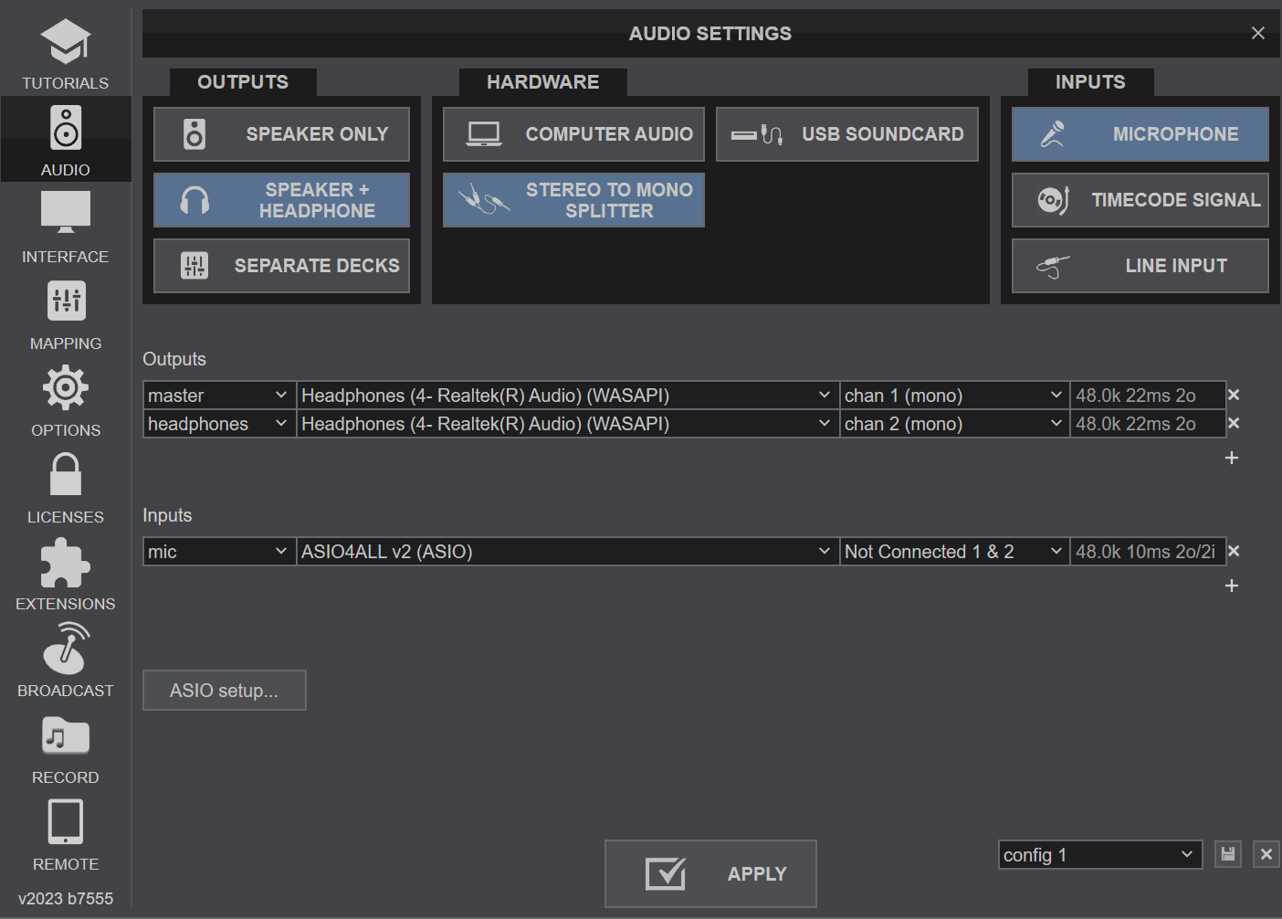

Hi djdad,
Thank you for your answer.
At the moment I am not using any controller, since I am just listening to which tracks may blend together smoothly before playing them in sets. That is why I wanted to split the audio of master and pre-cue in the headphones.
Below I am attaching the screen of my current setup

![](/img/385406/69298/Screenshot 2023-06-27 222926.png)

The Headphones output is routed to a Mono/Single channel. How do you expect to get different audio in Left and Right side ?
But probably miss-understood your original question and not interested in SplitHeadphones setting/mode.
If you dont get Master on one end and Headphones (PFL) on the other side, perhaps the "Splitter" cable you are using is not proper.
The side you get sound (Master), are you sure it's the Master ?
You have PFL enabled on at least one Deck, right ?
What if you swap the Mono channels, do you get the Headphones on one side and nothing on the other ?

The last time I used vdj I had a different setup and it was working just like I wanted. When I opened it recently I updated the software and the audio settings changed as the above screen.
I am not using any splitting cable, just the headphones in the laptop.
To answer your questions in order:
1 - Yes, the side is the master.
2 - I have PFL enabled on select
3 - I still get only the master, but on the other ear of the headphones

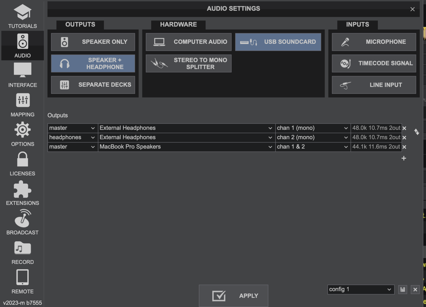

Try this:
In my estimation, this is going to be very hard to manage, since you'll also need to switch between the Master panel to control the mix in your headphones, and the Audio panel to actually control the mix.
![](/img/385600/87199/Screenshot 2023-06-30 at 11.43.39 AM.png)
Posted Fri 30 Jun 23 @ 4:47 pm
and for the record, there is no external USB audio card in this setup. Guessing it should still work with Computer Audio highlighted at the top.
