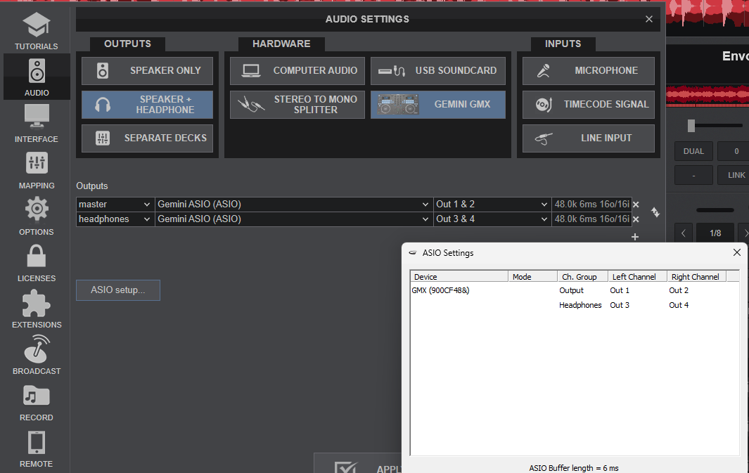

So, you installed Gemini ASIO ?
If so, you should have this in your VirtualDJ Audio Setup ..
https://www.virtualdj.com/image/64192/194685/AudioSetup.png

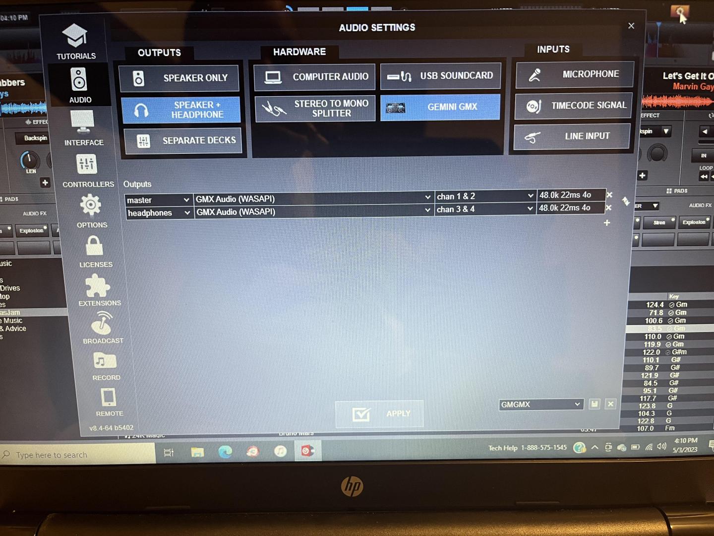

gemini asio
gemini GMXAudio(WASAPI)
those are the choices I get

Posted Wed 03 May 23 @ 9:17 pm
the screenshot was the config that I get sound out of headphones, with the ASIO I dont get anything

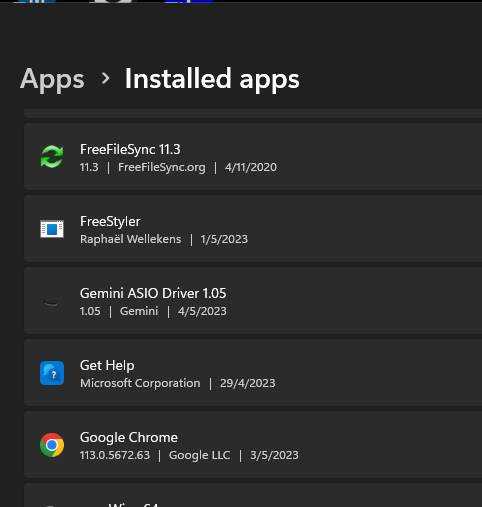

Tried here and audio worked fine, but had older version of Gemini ASIO installed. Then i tried the ver 1.08 form Gemini website and had no sound from Master.
Will contact Gemini and try to find out what happened with their latest ASIO driver, but in the meantime, install ver 1.05 from https://www.dropbox.com/s/1axkzs2xyzvs97g/Gemini_ASIODriver_WIN_1.05.exe?dl=0

I used the download you sent me, still no sound out of main,so this might be a stupid question, but if I my GMX is powered and connected via usb, should I not be able to hear out of master speaker on laptop?

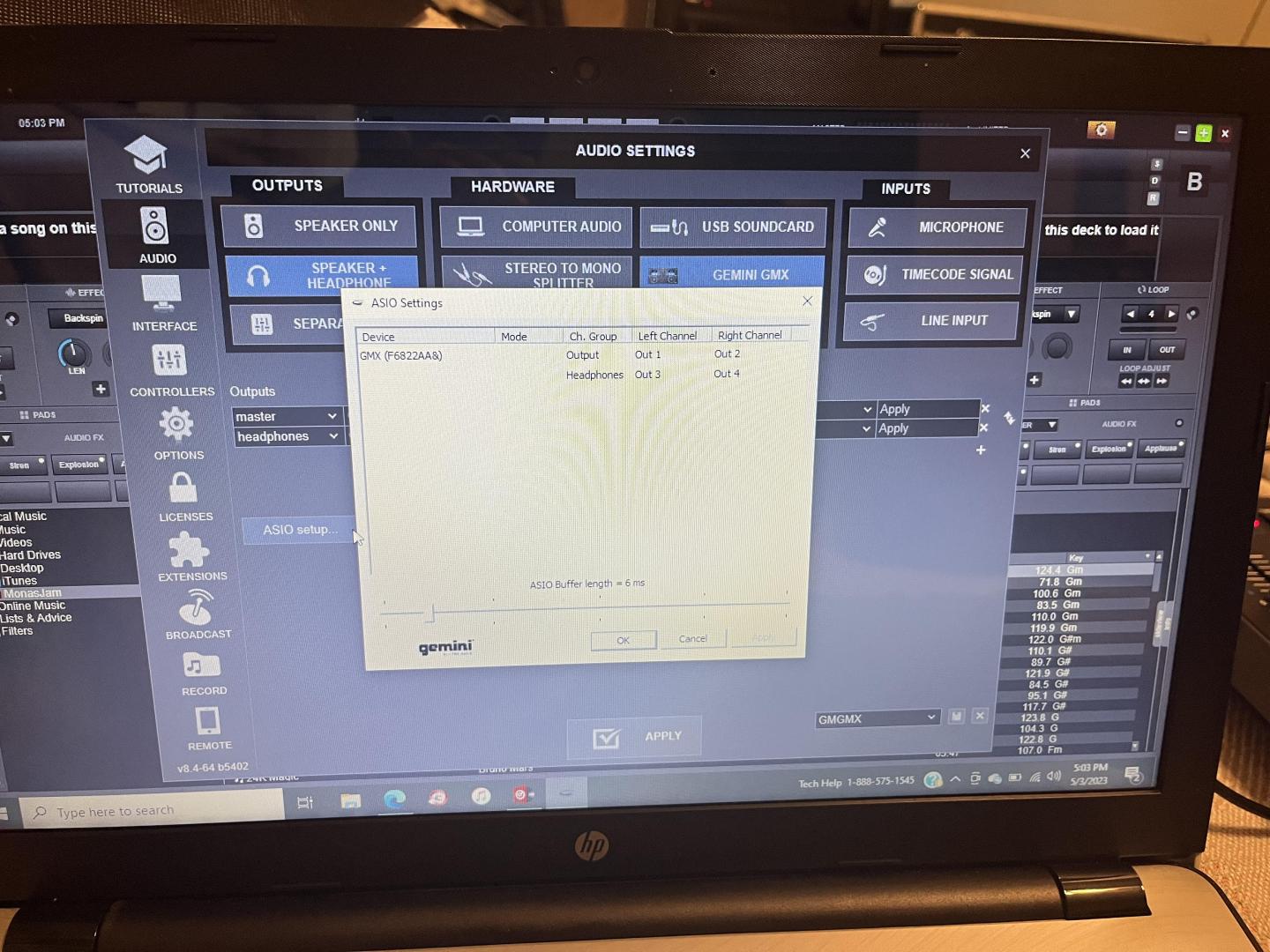

Posted Thu 04 May 23 @ 2:31 pm
So when I configure as such, I get no sounds out of master or headphones, and that's with the download sent earlier, as i said earlier, should I not be able to hear throgh master and haedphones if correctly configured? sorry for dumb questions, but it seems Im definitely not doing something and I have noticed that when I conigured as such, the I would press play and even the indicator at the top was moving as it did the day prior?
Posted Thu 04 May 23 @ 2:37 pm

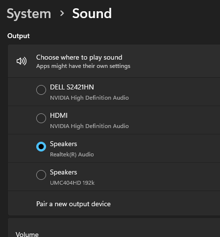

When you're using a DJ controller with an audio interface, you should be connecting speakers to the master output of the controller.
