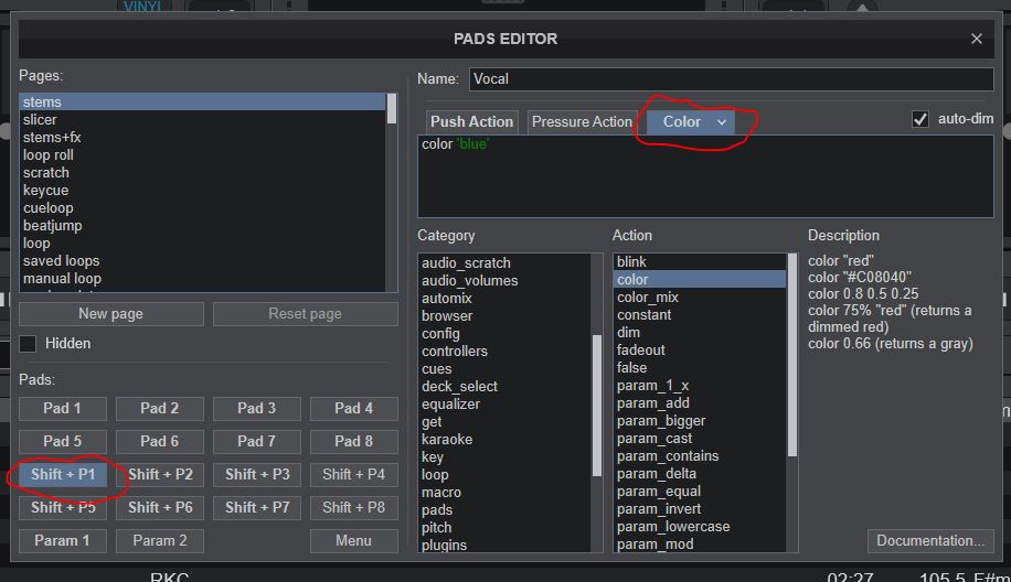

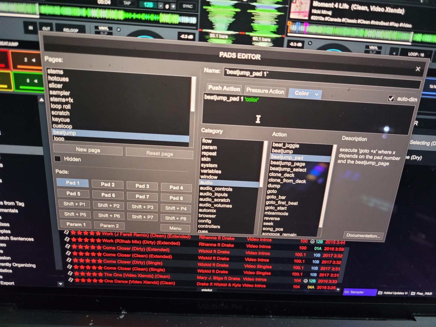

Please see the video of the problem here: https://nextcloud.greenislander.mywire.org/s/BmReSJzjByMkkDE
Here are some still pictures:

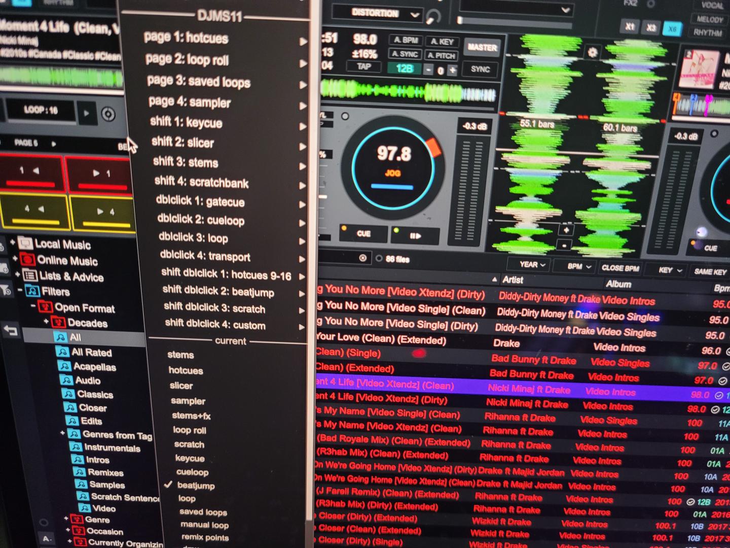

Pad definitions with DJM S11 connected:

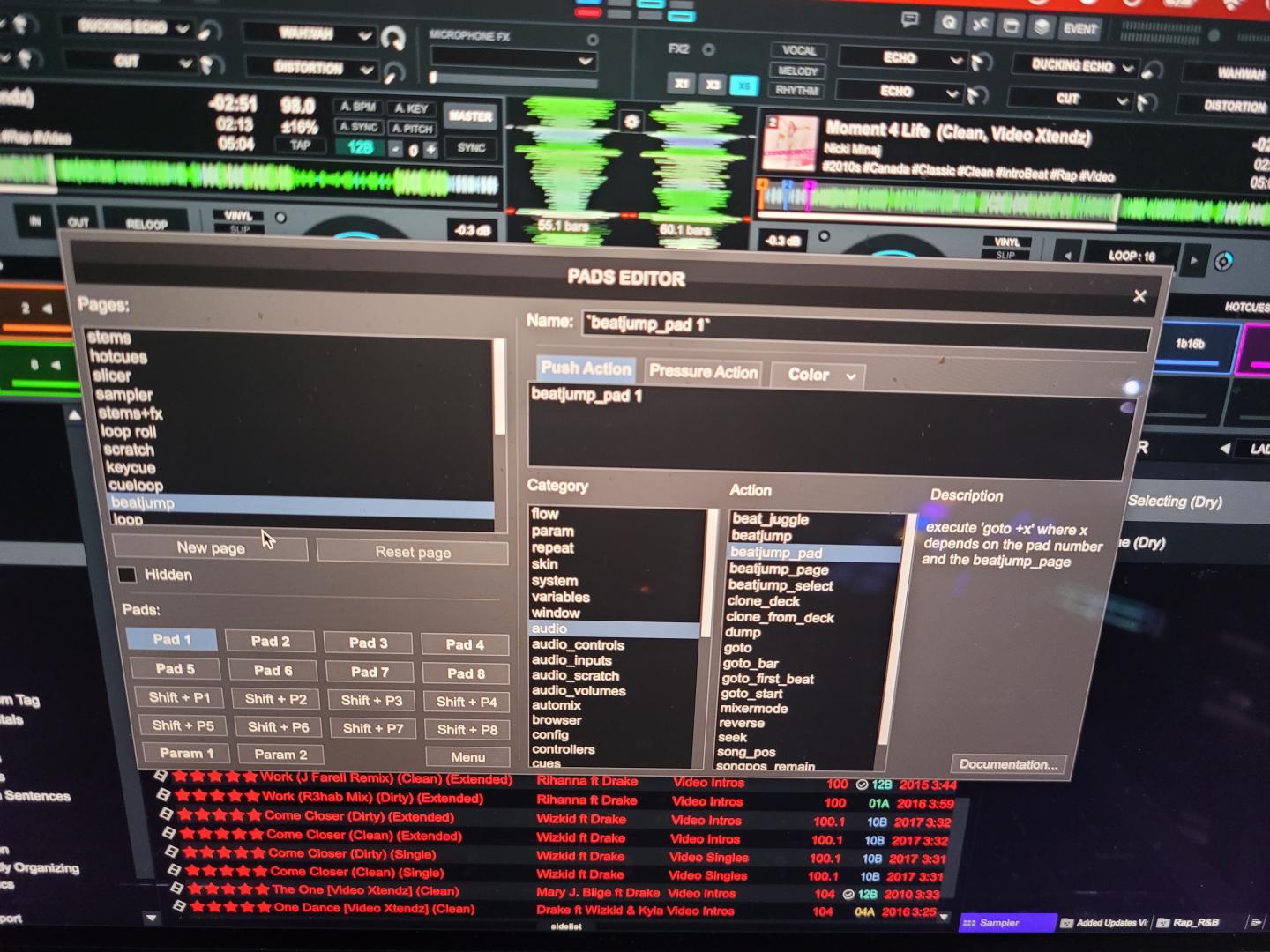

Beatjump Pad Page Definition (shift + dbl click Roll)
Beatjump Pad Page Color Definiton Example

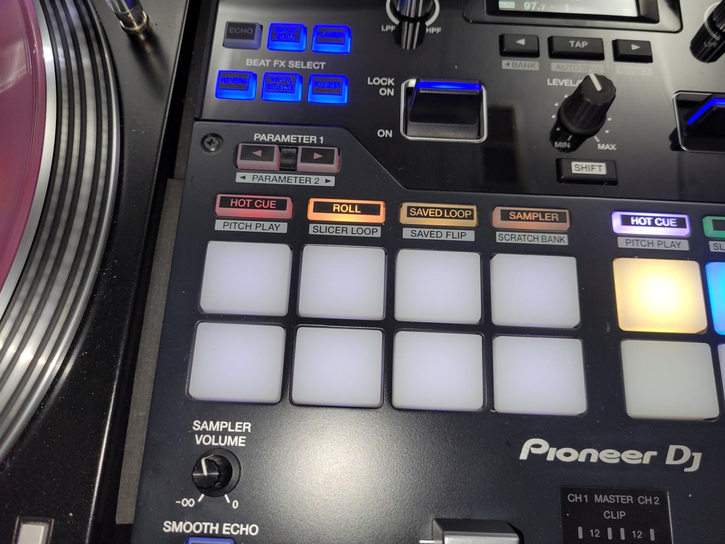

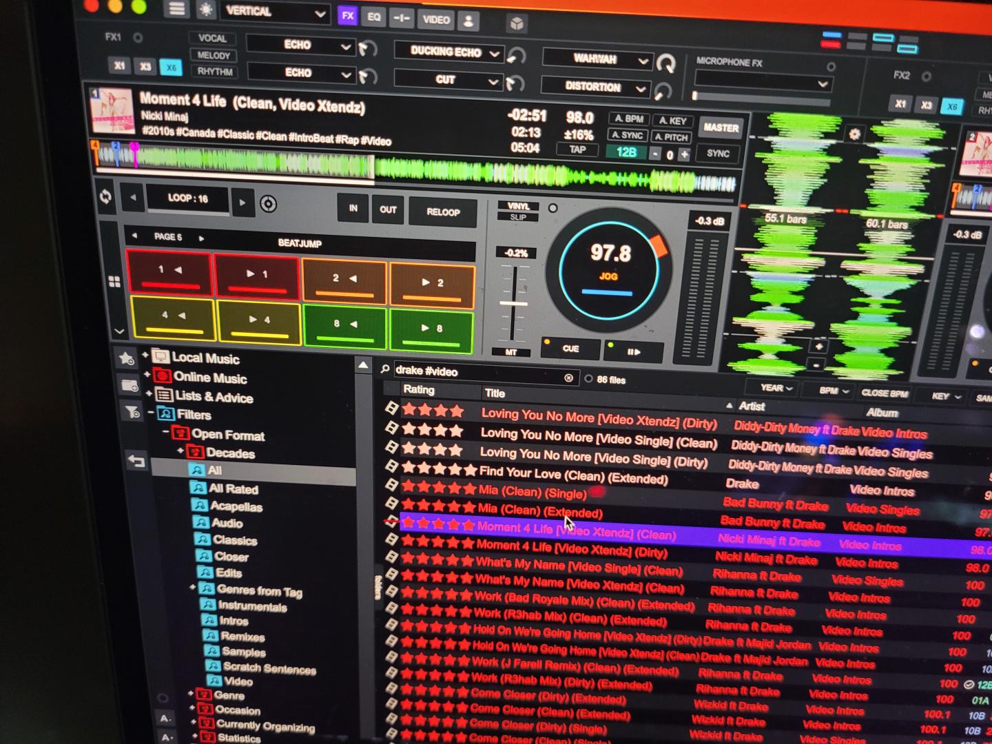

Pad display on software deck:
Pad display on the DJM S11 (no color):
Please note that the problem is not with shift + pad button action, the problem is with shift + dbl click pad page selections...there should be color but there isn't - it is showing the papd colors from shift + click of the pad page button.

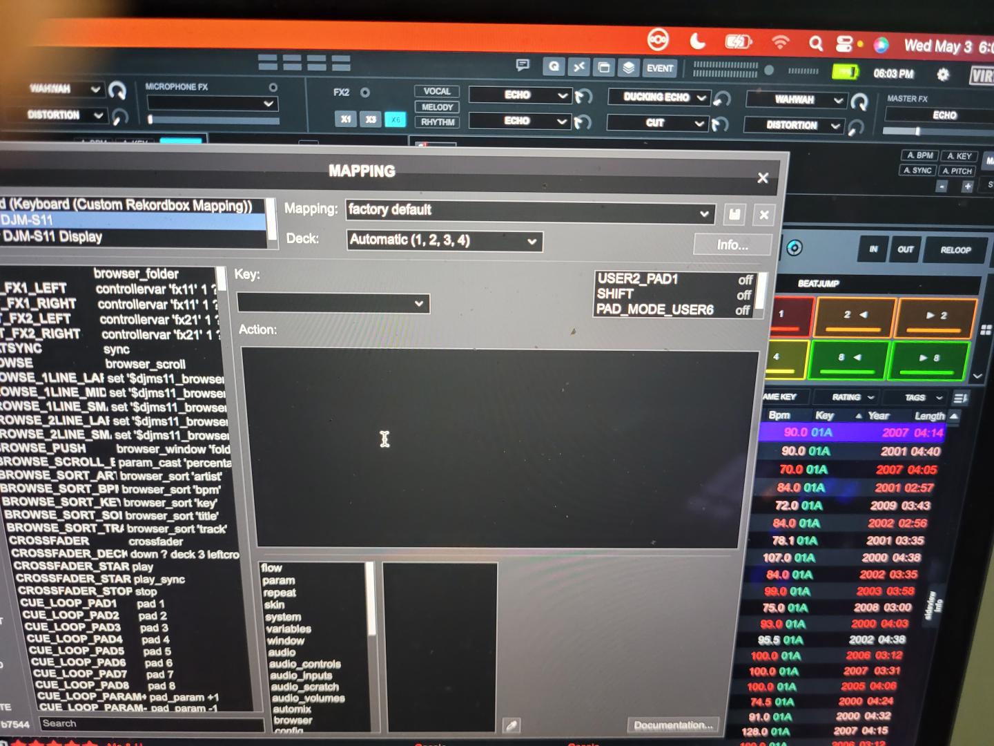

djdad wrote :
Can you check the name of the key when one of these is pressed , e.g. in Beatjump you get USER6_PADx in Settings->Mapping tab ?
See the image below for the shift + dbl click Roll (Beatjump, which you can see enabled for the deck in the background)
Pardon the roateded form of the image (not sure how to reorient it using BBcode)
Posted Wed 03 May 23 @ 9:26 pm

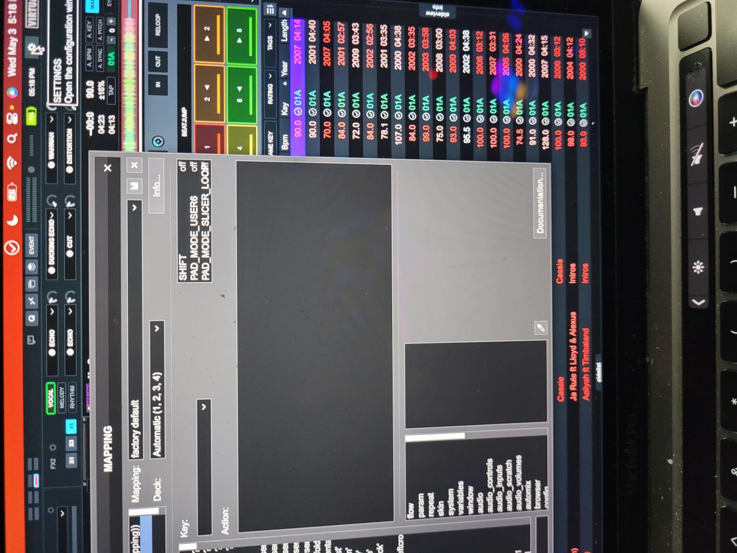

So while you are in Beatjump mode, what names do you get in Key Learn area (MAPPING) when you press a PAD ?
Do you get .. USER6_PADx or SLICER_LOOP_PADx ? (where x is the number of the pad you press)
Posted Wed 03 May 23 @ 9:52 pm
I get some combination containing USER2_PAD1 and PAD_MODE_USER6 (shift + dbl clock Roll + pad 1 press).
