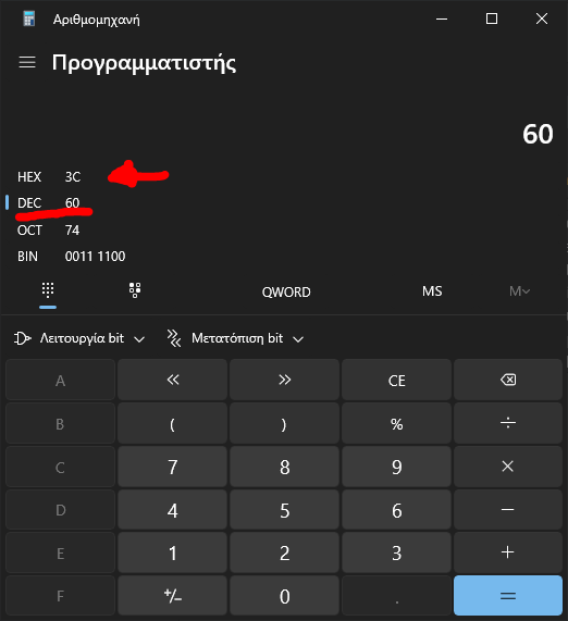

PS: It's quite easy to convert decimal data to hex.
However, instead of relying to tables, if you have the decimal notes information ready, you can use windows calculator to convert any number on the fly.
Start Windows Calculator, click on the top left menu and select "Programmer" mode.
Make sure "DEC" is highlighted on the left side of the virtual screen.
Then type the number you want, e.g. 60
You will see the corresponding value in HEX right above
Finally, if you know the correct HEX value for one note on your device and everything else fails, you can create your own table in Excel or another similar spreadsheet application.
