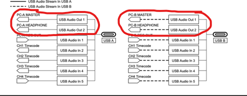

[quote=DennYo Beats]The PC Output has only 2 Stereo-Outs. One for Master and one for Headphones.
USB-A MASTER + HEADPHONE
USB-B MASTER + HEADPHONE
You can see this in the grafic:
Ah! Of course....all of the mixing happens in the software and just the master and headphone channels get sent to the console. Thanks for clarifying that for me!
No you can toute by software (rekordbox fashion via USB Master)or Hardware (Serato fashion) there is several USB X4 inputs or global input / output. Hope VirtualDj will map like Serato fashion to use internal hardwBeat FX. You have the choice in FLX10

What makes you think that since there are no available channels on the diagram to do this?

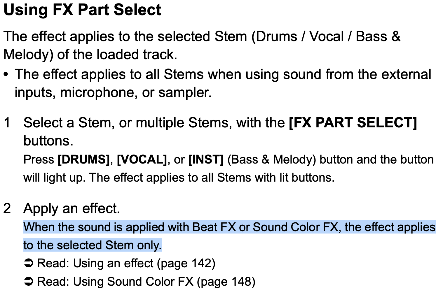

From the Serato section in the FLX10 manual:
So it seems that somehow the FX can be applied to individual stem parts in Serato.
