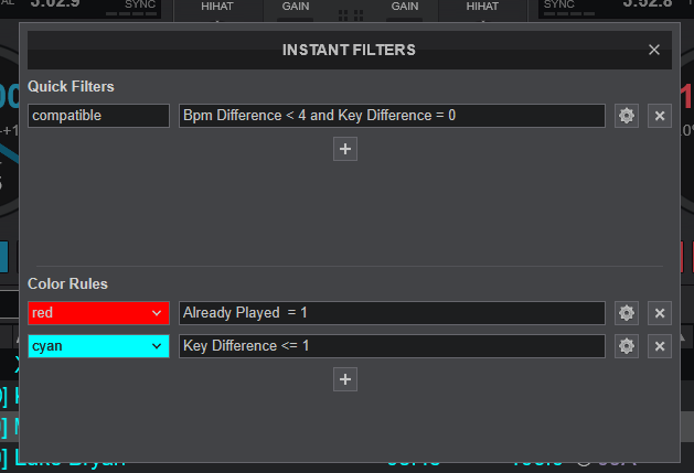

Do you have any Color rules ? If so, can u post a screenshot of your rules here ?

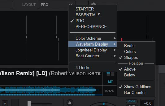

reverted to older version, same results. Also the choices for wave display is different. (both newer version and older one)
Here is pic of wave, and colors for compatible
Posted Wed 15 Mar 23 @ 7:30 pm
You do understand that color rules override manual colors, right ?
Therefore tracks that have been played will always be red, even if you try to manually set a color for them on Tag Editor.
Same applies for tracks that are compatible in KEY. According to your rules they will always appear cyan. No matter what color you set on Tag Editor.
Posted Fri 17 Mar 23 @ 1:19 pm

Now I'm confused.
Do you try to use more color filters?
If yes give us an example of the code you're using. Also keep in mind that color filters work top to bottom and stop at the first rule that is true for a given track.
So, if you create a third color rule on your above screenshot to paint all Rock songs yellow, but a Rock track is compatible to the current playing track, it will appear cyan, not yellow.

Makes more sense now; Thank you.
