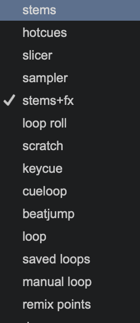

You don't need to change the mapping for stems, it's in the pad section onscreen. Just select from the dropdown menu different pads for different purposes. Stems, Hotcues, Stems+FX and did you know there is also Remix Points in there that are created when your files are analysed???

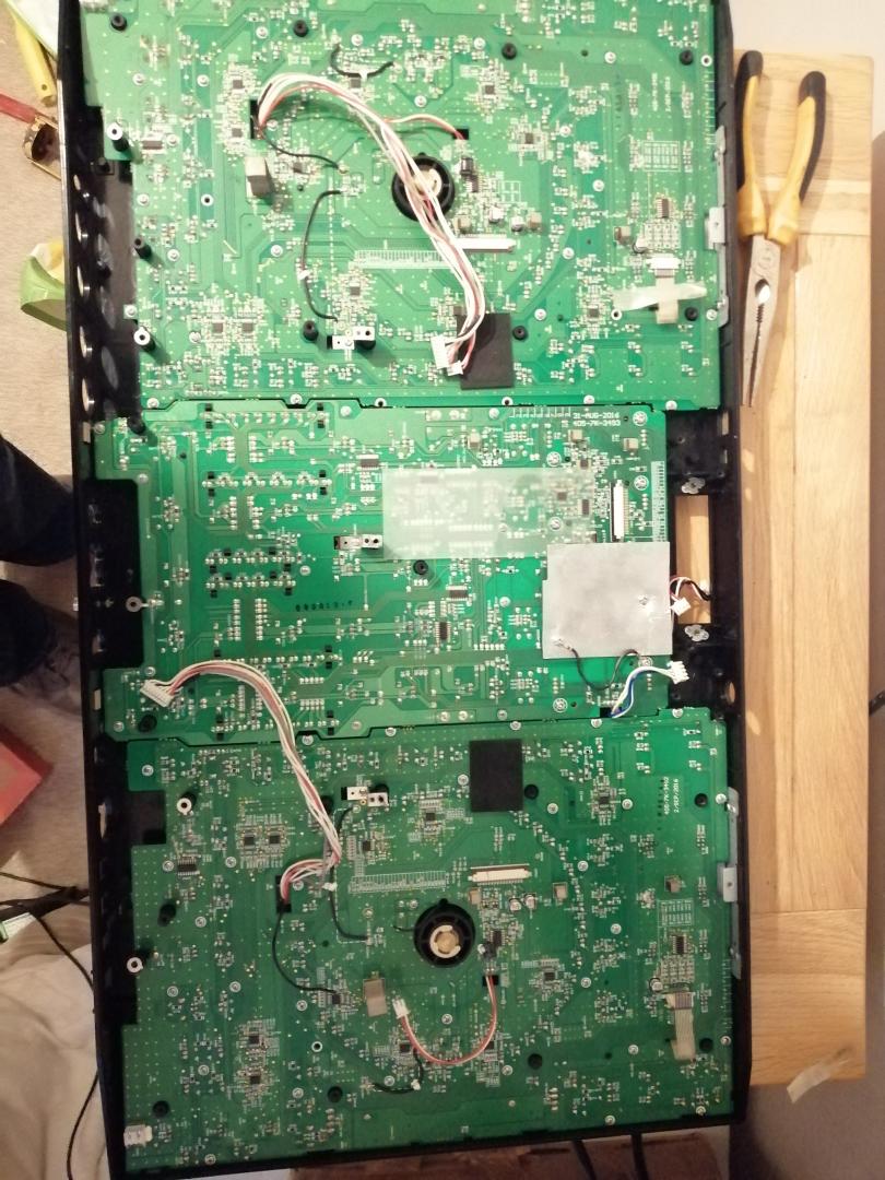

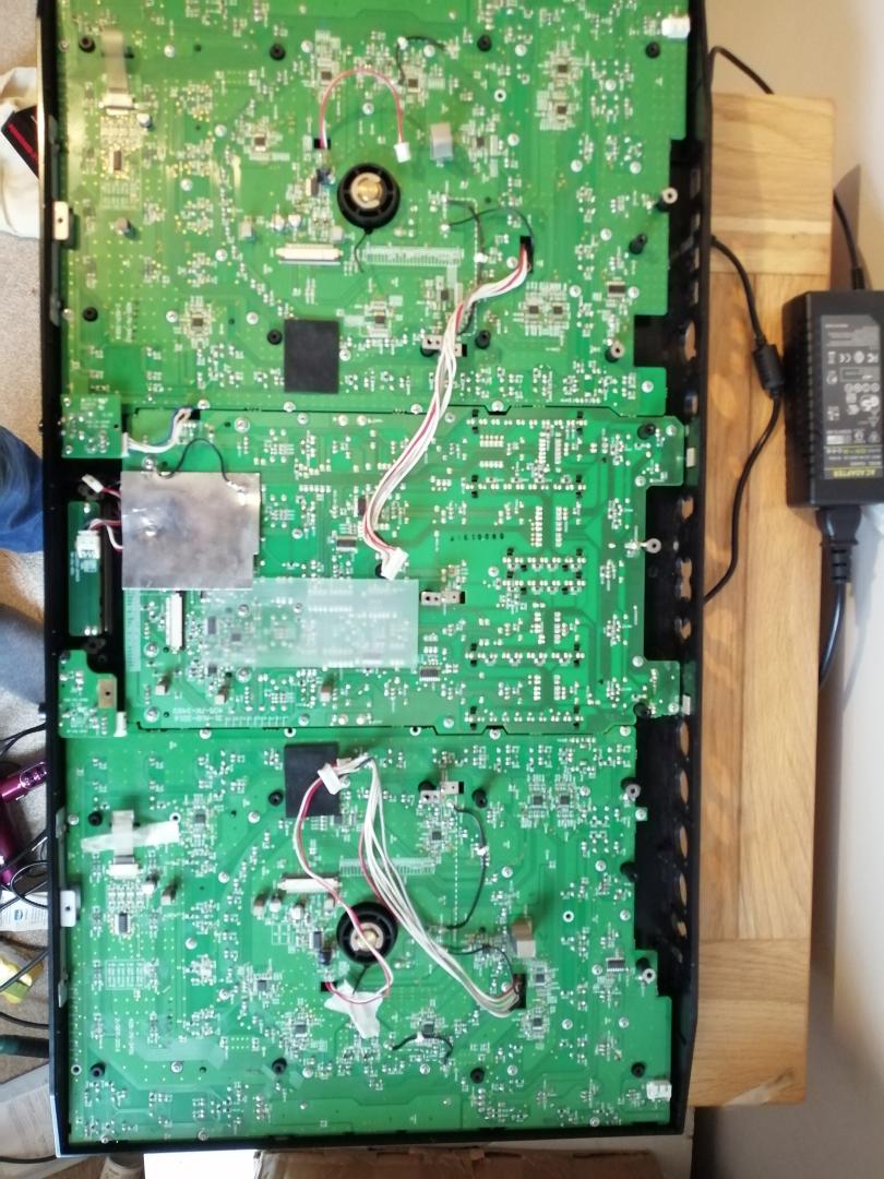

Was very brave today
Decide to take a look at the dodgy mic 2 button
So after removing all the knobs, face plate, back terminal board, so many screws I have lost count
About another 30 screws to remove the left deck pcb
This unit has definitely been opened up before
Found that the plastic mic 2 button was not sat on its little plastic pegs correctly, the actual switch was fine, so 30 seconds to put right, no parts required, still building it back up
Posted Mon 27 Feb 23 @ 6:20 pm

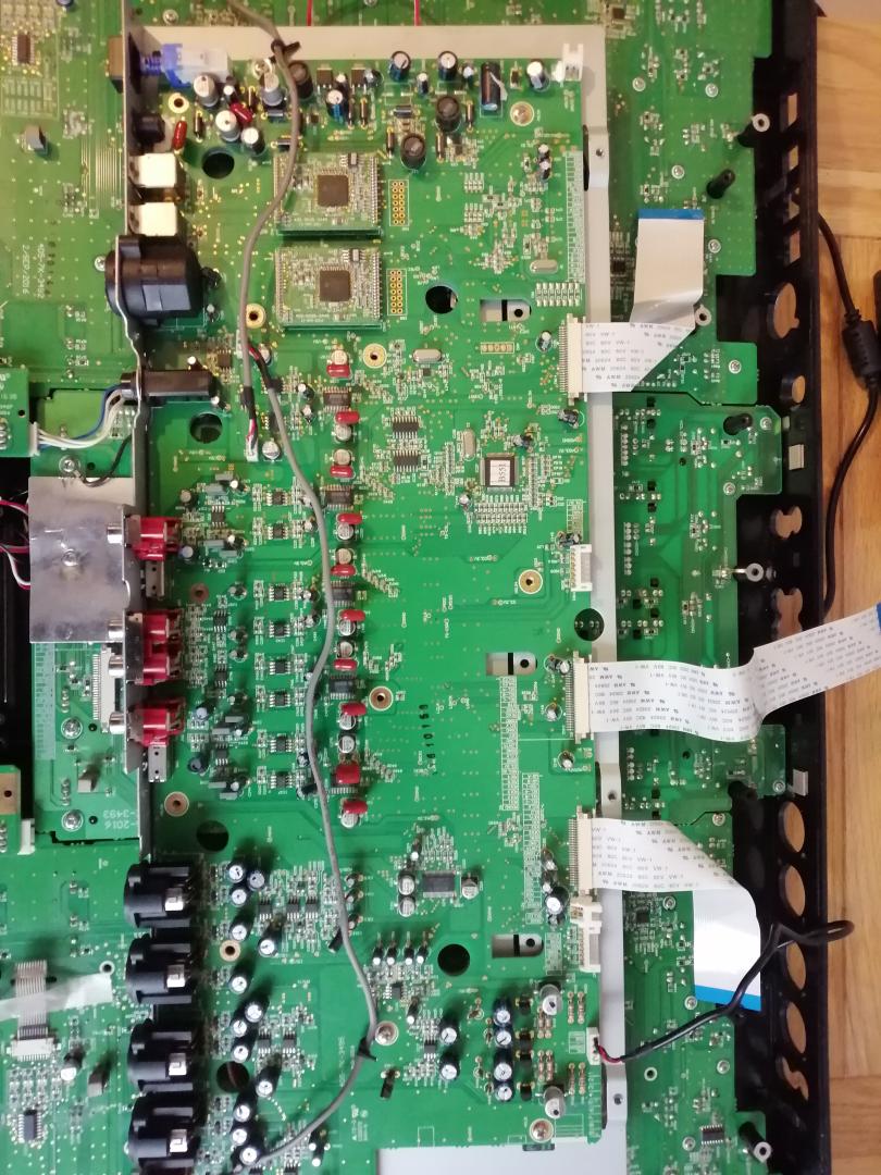

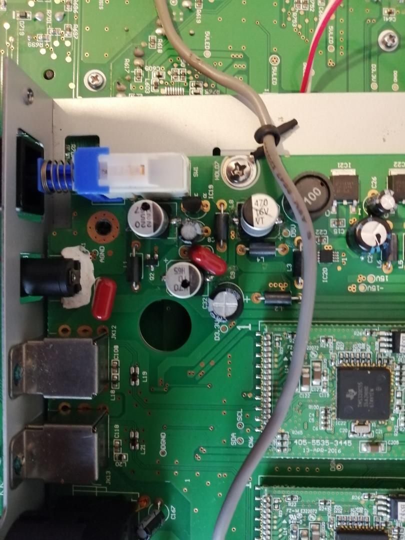

Well after re assembly, and having a good play around with the unit, fitting a couple of replacement knobs I thought I had done
Until random problems with the unit not starting up, after doing the usual tests, I found it was heat sensative, so probably a dry cap in the on board psu or a fulty CPU_RSET line
So another strip down to find the culprit
Although the unit runs off 5v, looks like the internal cpu is 3.3v, with no diagram it's hard to tell exactly where the fault is, but it's a dry 100uf cap right next to a sma ic (probably the _rset) and the switching 3.3v supply
Anyway replacement cap and it all powers up correctly every time now, phew
