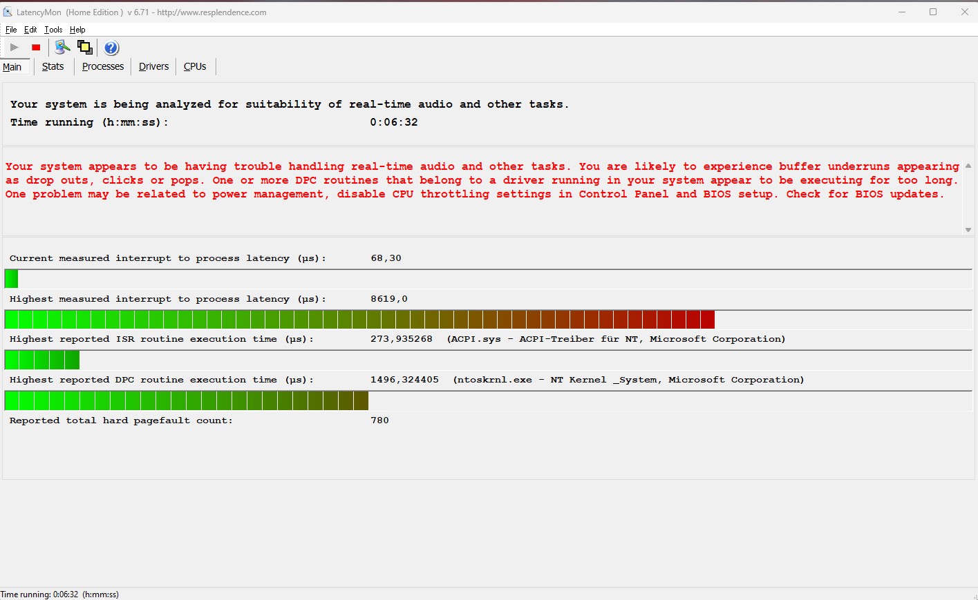

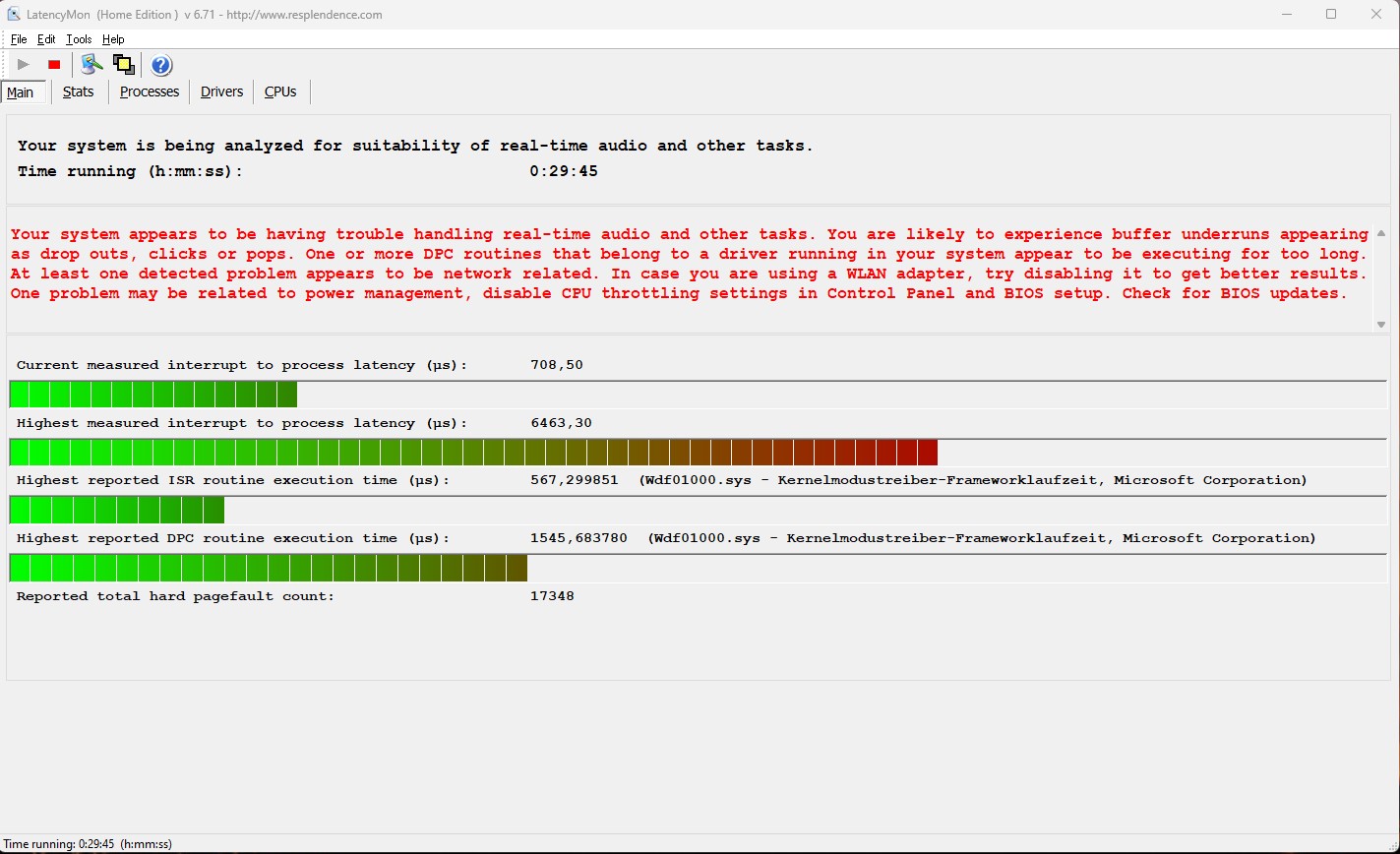

DJ GDWPRO InfinityMember since 2010
Yes, the error also occurs without Stems. I started Latency Monitor and took screenshots too

Yes it run with best performance .Latency see my screenshots
Posted Fri 03 Feb 23 @ 5:30 pm
