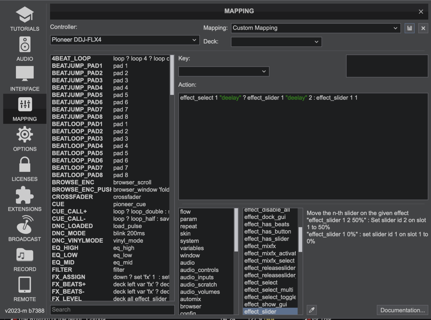

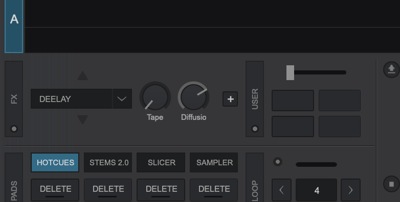

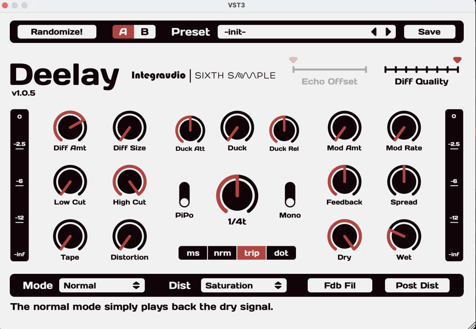

Hello,
I am having trouble trying to research how to do the following function. I have loaded in a VST plugin called Deelay. It has mapped a control from the vst to the effect slider 1 knob that I do not want to use which is called Tape. I would like to have the Wet knob mapped. How can I change which knob in the VST gets mapped to the effects_slider 1 knob specifically just for this vst and does not effect other plugins when I change it out?

effect_select Y EFFECTNAME ? effect_slider Y EFFECTNAME X : effect_slider Y 1
x being slider number. y being effect slot

I can not seem to get this to change anything. Have you tired this yourself with a VST plugin? No matter what I enter for a number the knob is not changing to a different setting of the vst plugin.

show me your script.

effect_select 1 "deelay" ? effect_slider 1 "deelay" 2 : effect_slider 1 1
I've tried switching out that "2" in every spot and no change in virtual dj changing from "tape" to any other setting within the Deelay VST plugin. I am also not trying to assign a key to this so that box is left blank as my FLX4 controller is already mapped. The software does not show anything changing out the effect parameter after I hit save. So again when I load the VST called "Deelay" it loads to parameters, one called Tape and the other called Diffusio. I want to change what auto maps to those two knobs. I want to remove Tape and have the Wet ratio auto load to that first knob. I hope that made sense and I appreciate your help with this.

yeah the skin will show what it is written to show, effect_slider 1 1, unless you edit the skin.
try testing with the custom slider.
the script is good.

I am really wishing this was a feature now so this could be much easier to swap out. Do you know how I could edit the main skin to make that adjustment so that it shows what I want for those two knobs per changing each different VST and us this one for an example. I would like to do this so I have a visual aid. Thanks
