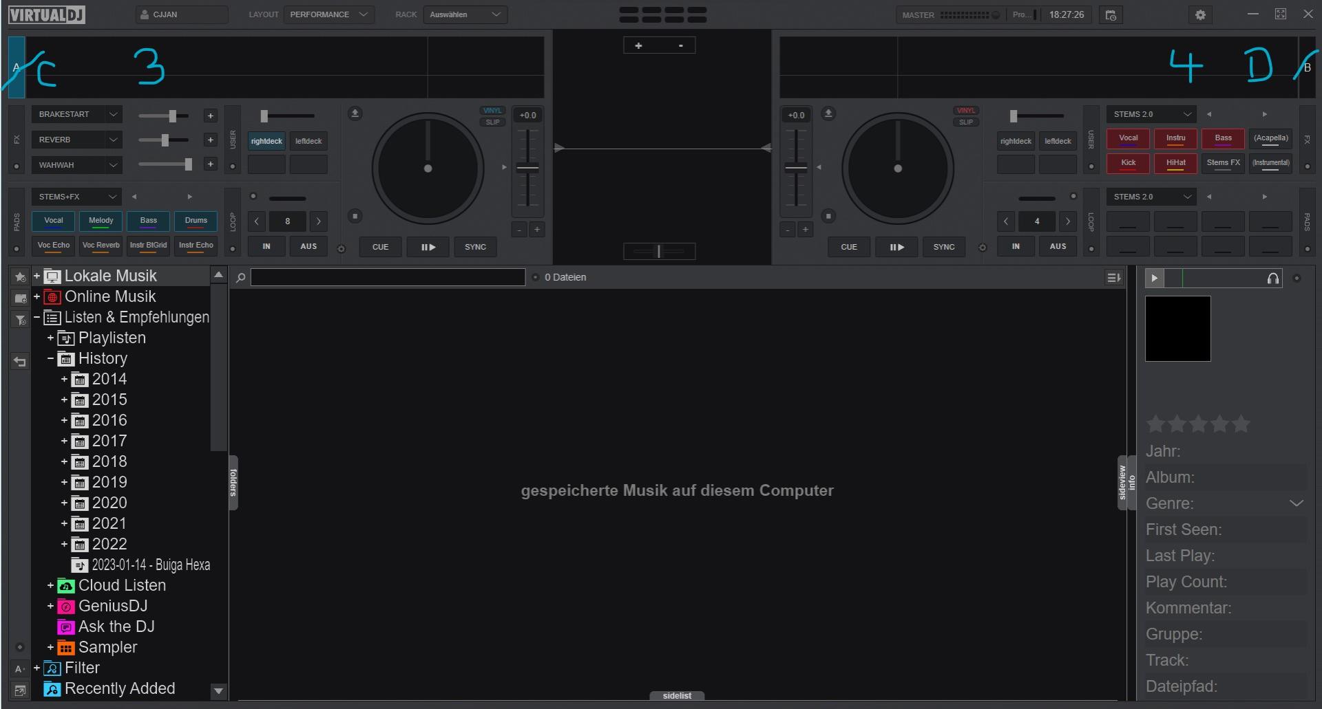

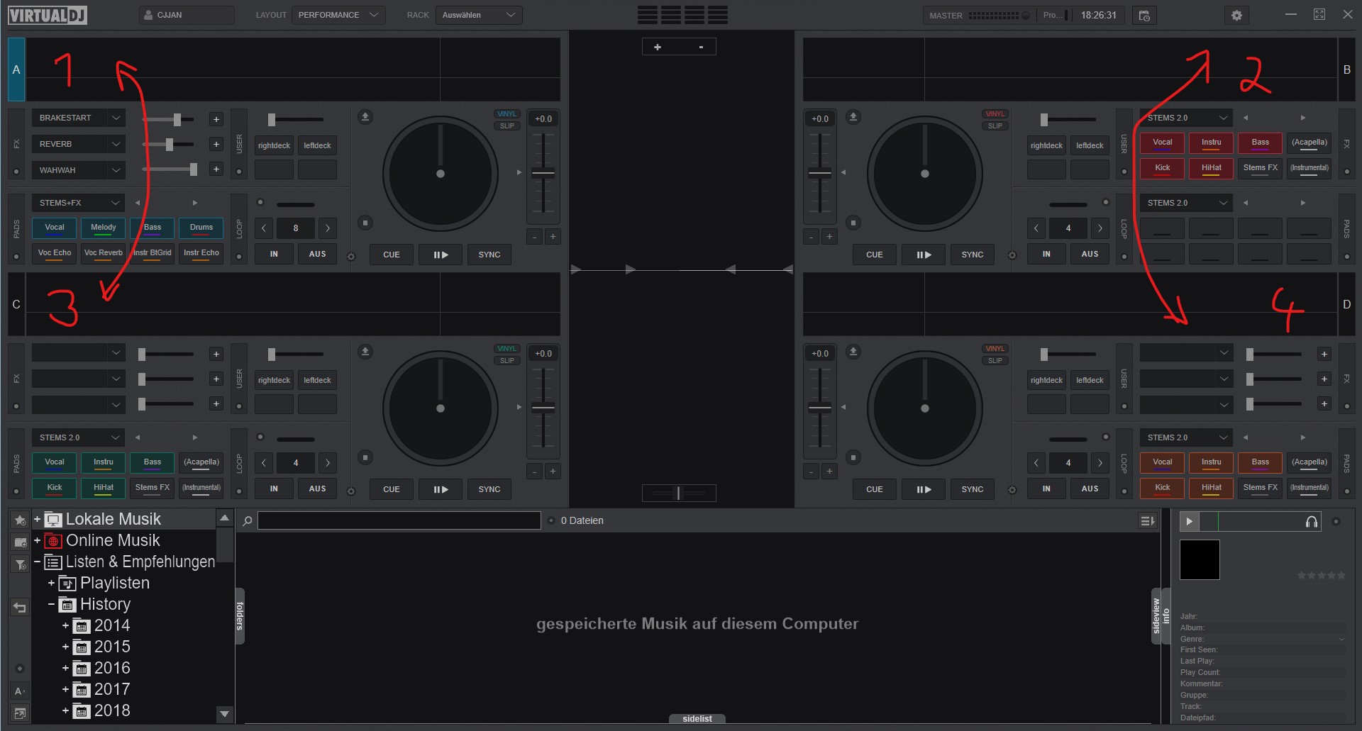

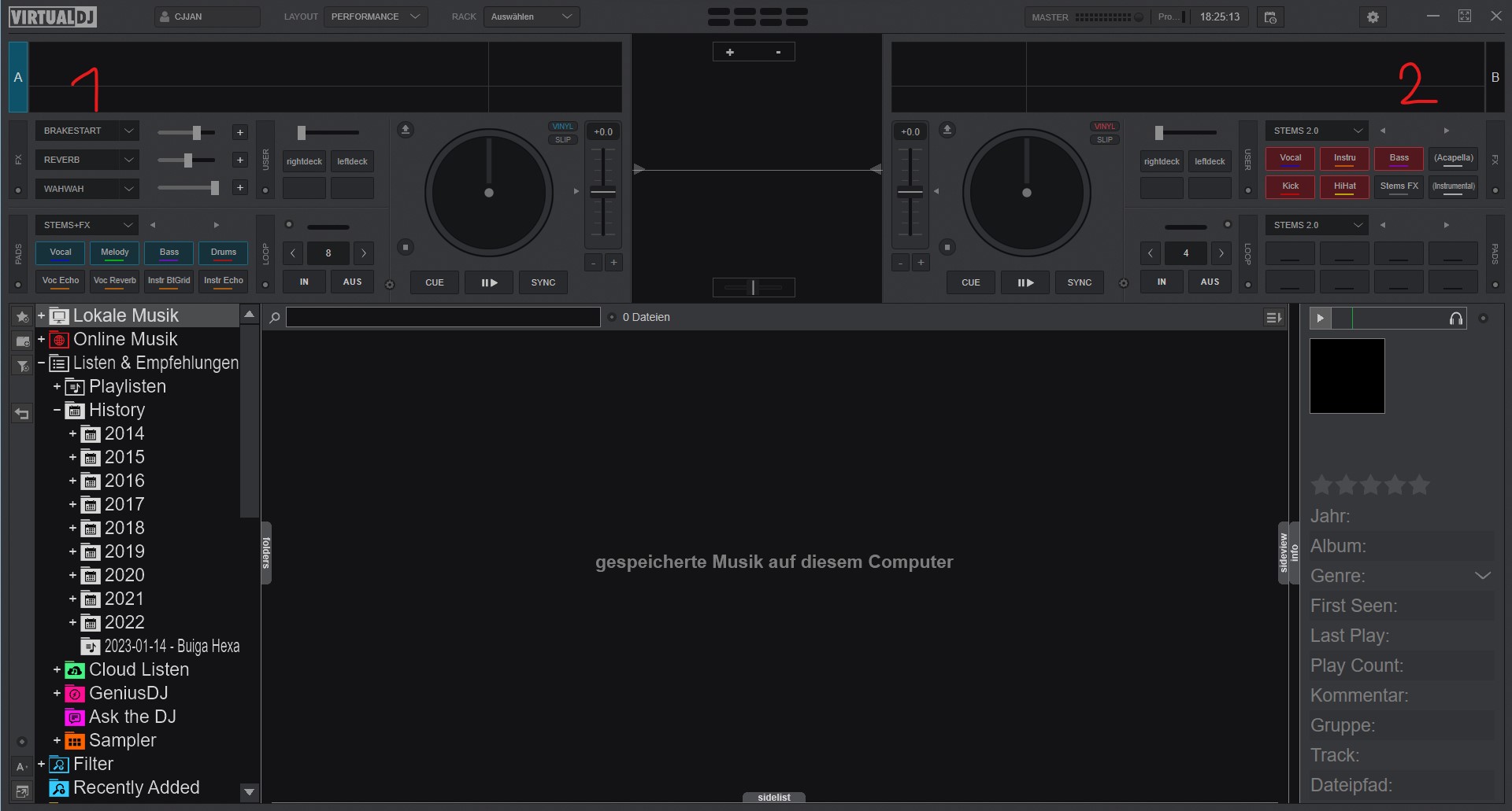

Hi VDJlers,
we play B2B on a DDJ-1000 SRT with two notebooks, both rund VDJ Pro.
As skin we use the VDJ stock Performance mode skin with vertical waveform.
Computer 1 = Deck 1/2, DDJ channels 1/2 (in the middle)
Computer 2 = Deck 3/4, DDJ channels 3/4 (left and right channel)
So computer 2 always needs to extend the view to four decks, otherwise we would not see whats happening on the deck in VDJ.
We've thought on switching the option "mixerOrder" from 3124 to 1342 on one computer.
That solves the Audio routing and mixer layout issue, but we can't switch the decks anymore on the DDJ.
My idea was it to change options in the skin, but couldn't found a solution to that.
Is there a way to manipulate the stock skin to have on Skin Deck A = 3 and Skin Deck B = 4?

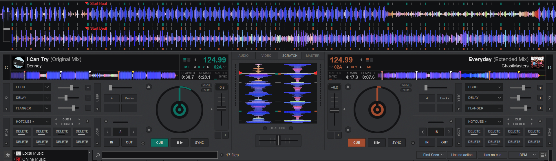

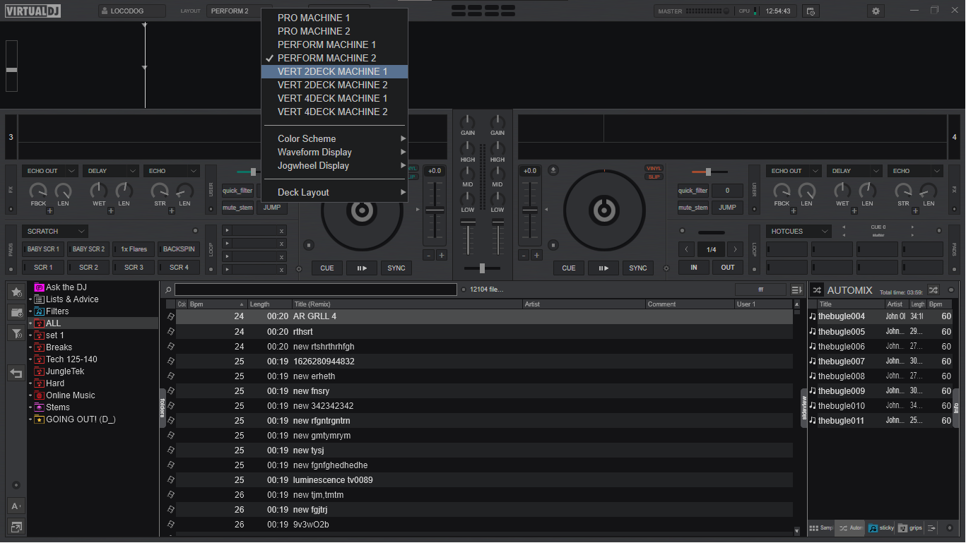

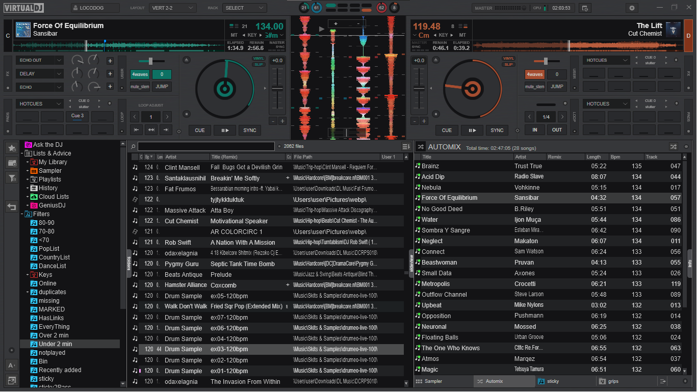

A good chunk of visual progress, but still lots of bits that could break the thing need looking at
2 decks, but 4 waves [can also just show 2] for the 3&4 machine
same for the 1&2 machine, same picture different decks
4 deck vertical for both machines too, all the little bits to look at sorting out to make it impossible to break.
racks need looking at, but a good amount of progress.

Wow, thats some super fast progress!
Two Waveforms would be enough at the two deck view.
If you'd like to share your pro view with me, i could check if this is already good for us.

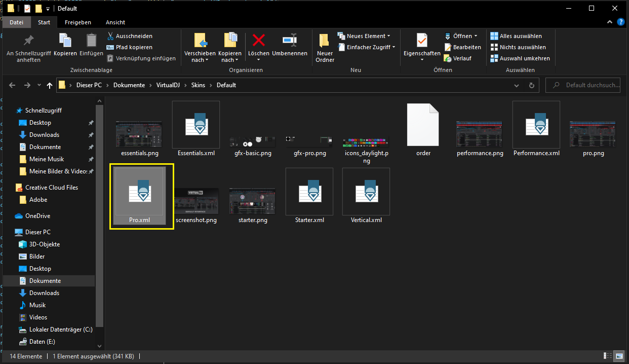

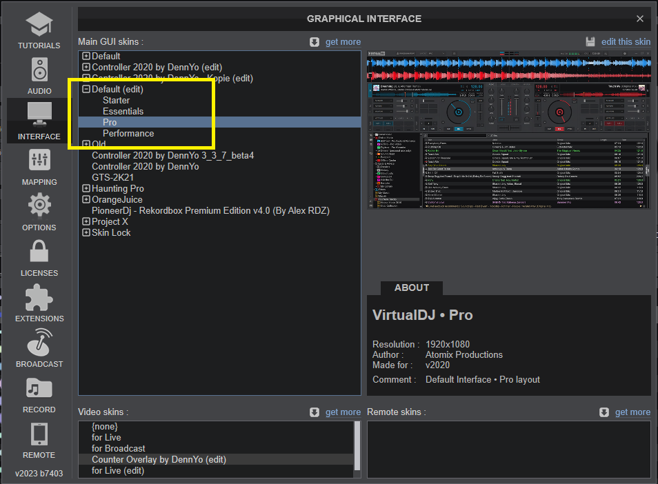

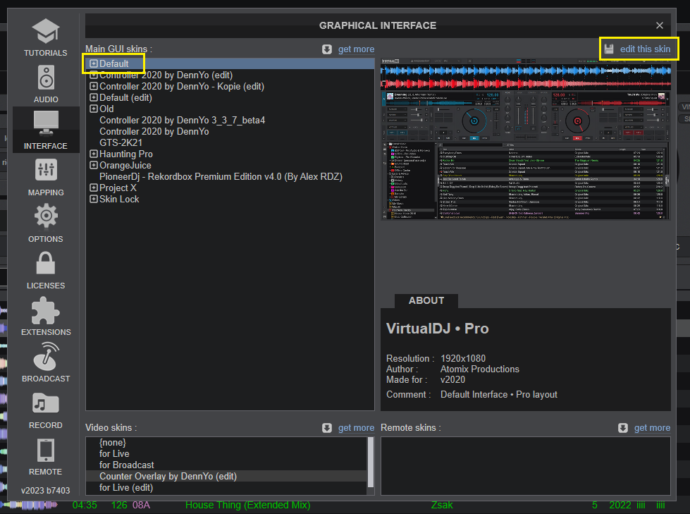

EDIT: I see you use the default / performance. The way to change is the same. ;)
_________________________________________________
This is simple to config.
go to the Settings/Interface
Click on "default skin", then on the right corner "edit this skin".

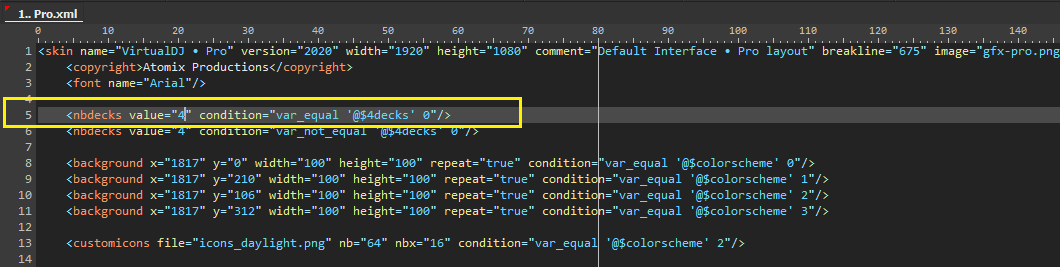

Open the performance.xlm and change the 5th line value="2" to value="4".
Original
Change
After changing go to Settings/Interface and select the Skin "default (edit)".
The 2 Deck Variations swaps now. Deck 1/3 and 2/4.

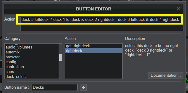

Create a custom Button with the following code:
Original
<nbdecks value="2" condition="var_equal '@$4decks' 0"/>
Change
<nbdecks value="4" condition="var_equal '@$4decks' 0"/>
deck 3 leftdeck ? deck 1 leftdeck & deck 2 rightdeck : deck 3 leftdeck & deck 4 rightdeck

3)On the "second" PC create a custom button with the following code and press it once:

I was on Decks 3-4 with the modified skin, my buddy was on decks 1-2 with the stock skin.
Best regards, Jan
heres my feedback on this topic.
First of all a big thank you to all who helped me with this one!
For me both skins worked, we had a fun night till 3:30 am, everything worked rock solid.
Best regards, Jan
