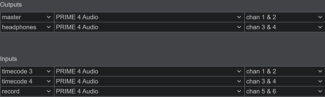

To be precise on the controller. It is a Denon Prime 4 using line-in of channel 4, wich is channel 3-4 (mono) from the sound-device perspective point of view. Not in the "line-in" configuration but in the "timecode-bypass" configuration.
Here is the screenshot:
Soundswitch plays so called "auto-loops" for songs that haven't been analysed beforehand. And yes, this is working for a beat sent via OS2L protocol.

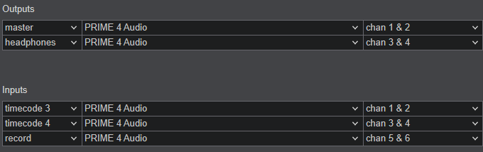

Hey Tomas,
make sure that you do not use the "native" line in of your controller, meaning that you must route the analoge signal through VDJ via a line in or timecode channel. (In case of the Prime 4: Do not use the little switch on the front of the controller. Leave it on USB. Otherwise the signal will not be seen by VDJ and therefore no beat nor grid can be used to send to Soundswitch.)
Here is a screenshot of my audio-config:
First load any digital track on the deck you want to process the analogue signal. See the last video for that.

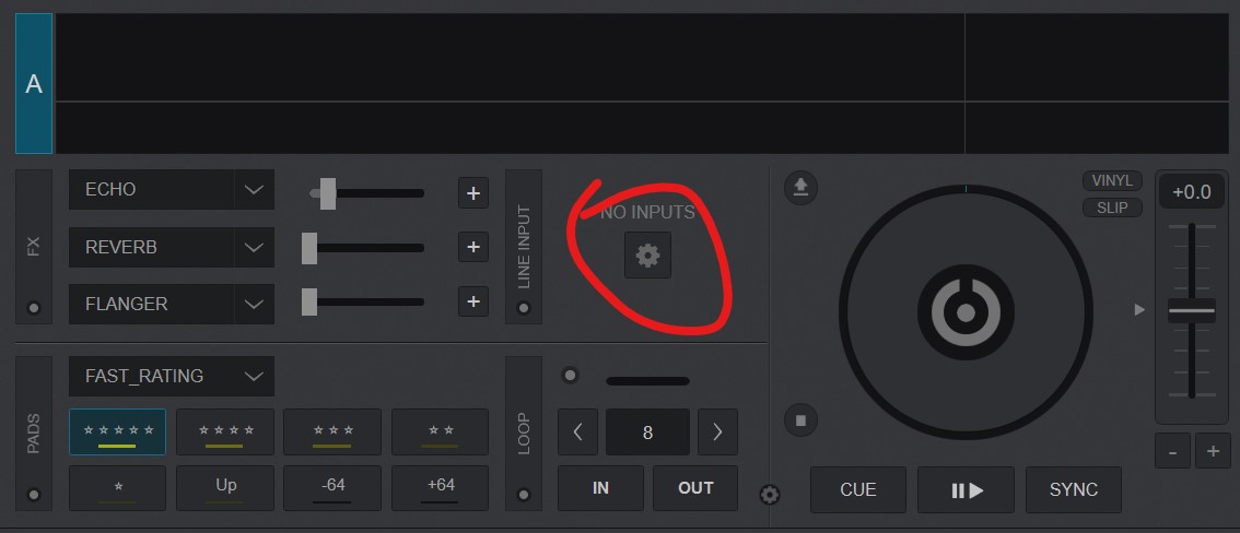

Then switch the deck to either line-in or timecode. You can use the userinterface for that:

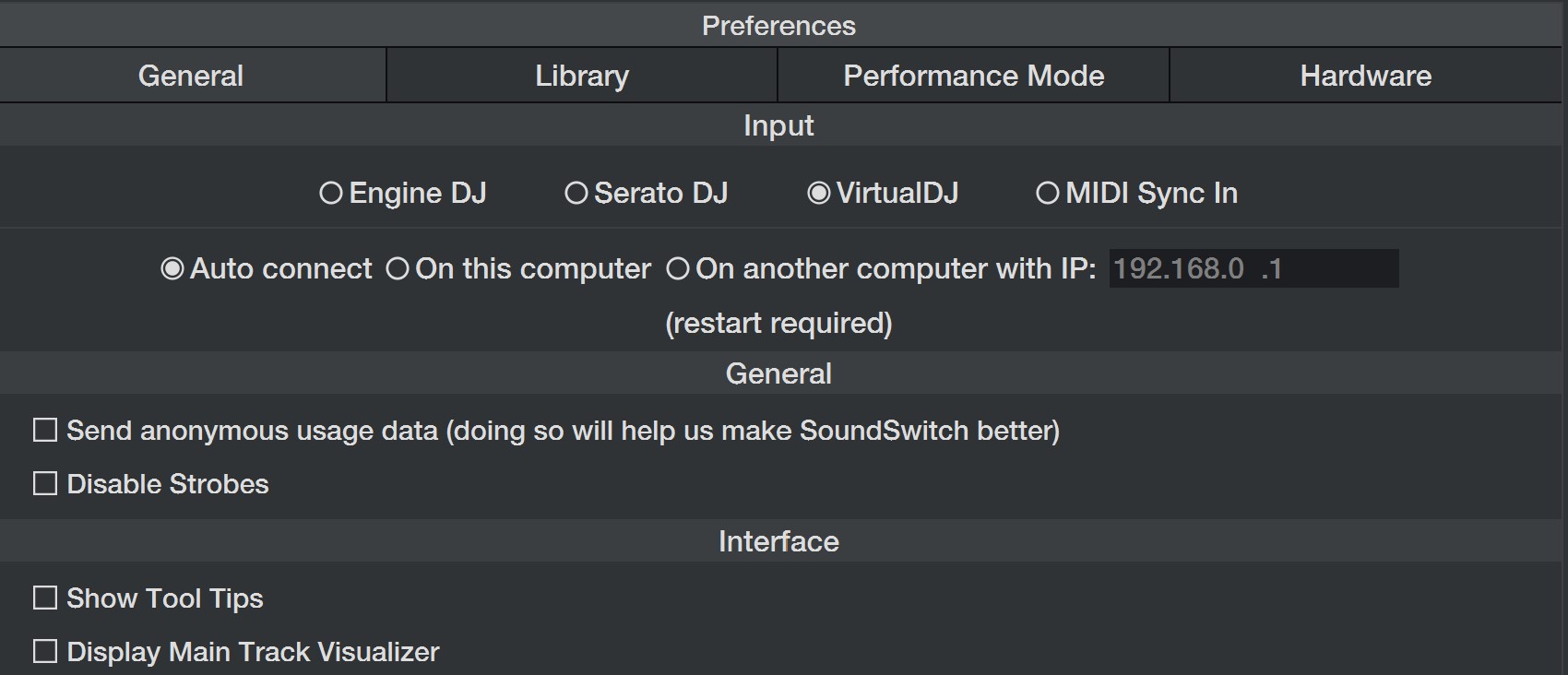

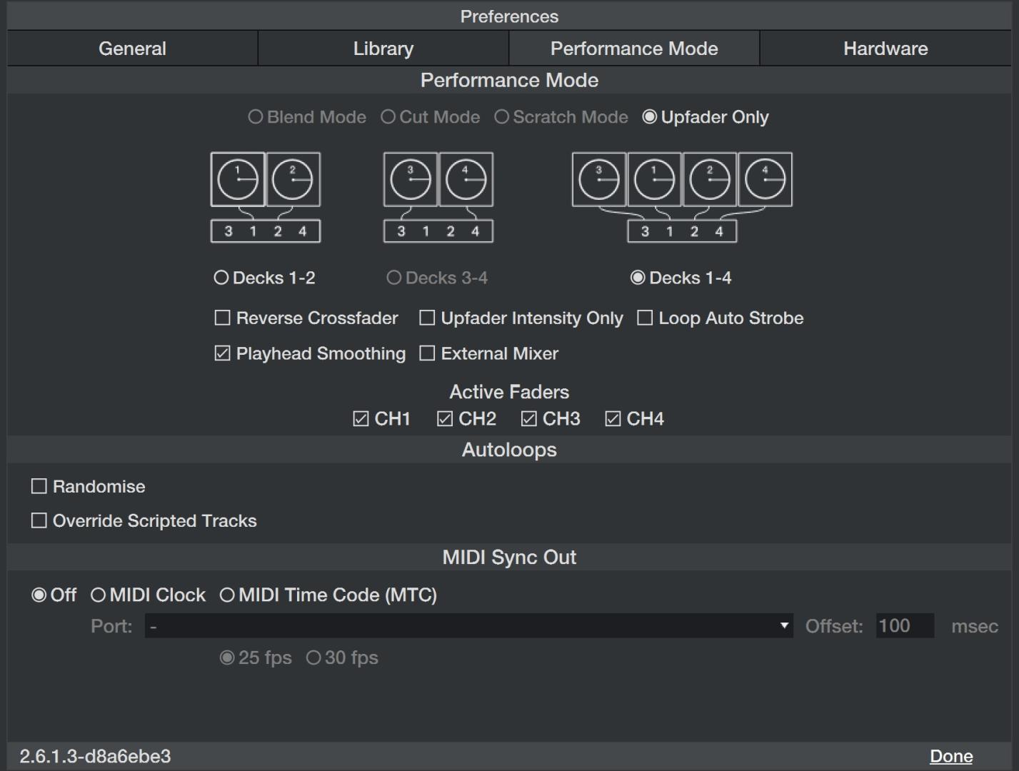

If you're able to control lights for digital tracks successfully with VDJ, then this screenshot may not be interesting. But for completion I attach my Soundswitch configuration:
And make sure to enable 4 decks if you want to process something, that is on deck 3 or 4.
