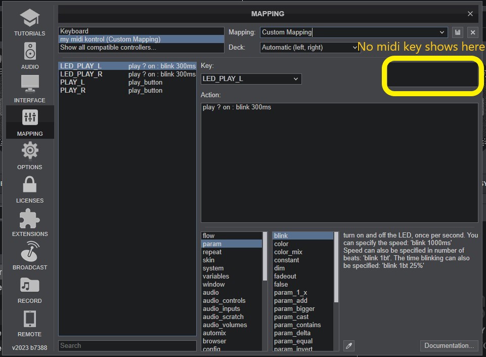

It does not work for my setting (no play at all and no effects on button's lights and no capture of any midi key).
I have the two buttons to play deck 1 and 2 respectively using the same midi channel 1 ("0" in the definition file) but different "notes" (although I also remapped the midi device to match the notes and the channels as per your suggestion) With this special mapping coupled to the definition file, at the start of VDJ I am prompted to confirm the connected device , but at the mapping screen, am I suppose to see activity of the midi keys on the upper right of the mapping screen (see screenshot, nothing appears there when pressing midi keys , unless the file is deleted)? Again, if I deleted the custom definition file, all midi keys are capture by VDJ but not with the def file in place.
Here is the xml definition modified:
and the mapping file
I appreciate your help

Ooops! Good catch @locodog. Now both play buttons work. But there are two issues
1. The led lights do not receive the signal to change accordingly. The buttons of the midi are set up as "toggle buttons" and by default they light up with value of 127 (0x7F) and are off with 0x0. There are two possibilities: a) the definition is wrong or b) the midi device does not allow the individual led light to be program.
I tried this in the definition file
2. With the definitions of buttons as "note" I have to press twice twice the button to play the track. I converted the button to "cc" and now they work pressing them only once. Is there any side effect on using cc as "opposed" to "note"?
<led cc="0x3F" name="LED_PLAY_L" default="PLAY_L" channel="0" deck="1" />or
<led cc="0x3F" value="0x7F" ccoff="0x00" zero="0x00" sendstatic="true" name="LED_PLAY_L" default="PLAY_L" deck="1" channel="0" />none of them worked
<button cc="0x3F" name="PLAY_L" channel="0" deck="1" />
<button cc="0x51" name="PLAY_R" channel="0" deck="2" />

No effect on lights. I set up the key as "note" first as "momentarily" then as "toggle" Upon pressing the key, the track plays but there is no effect on lights (the default behavior remains the same, meaning the lights is on only momentarily when pressing the midi key)
Posted Wed 11 Jan 23 @ 8:37 pm
Solved by editing the midi controller to leds "externally" controlled (default was "internally" controlled)
