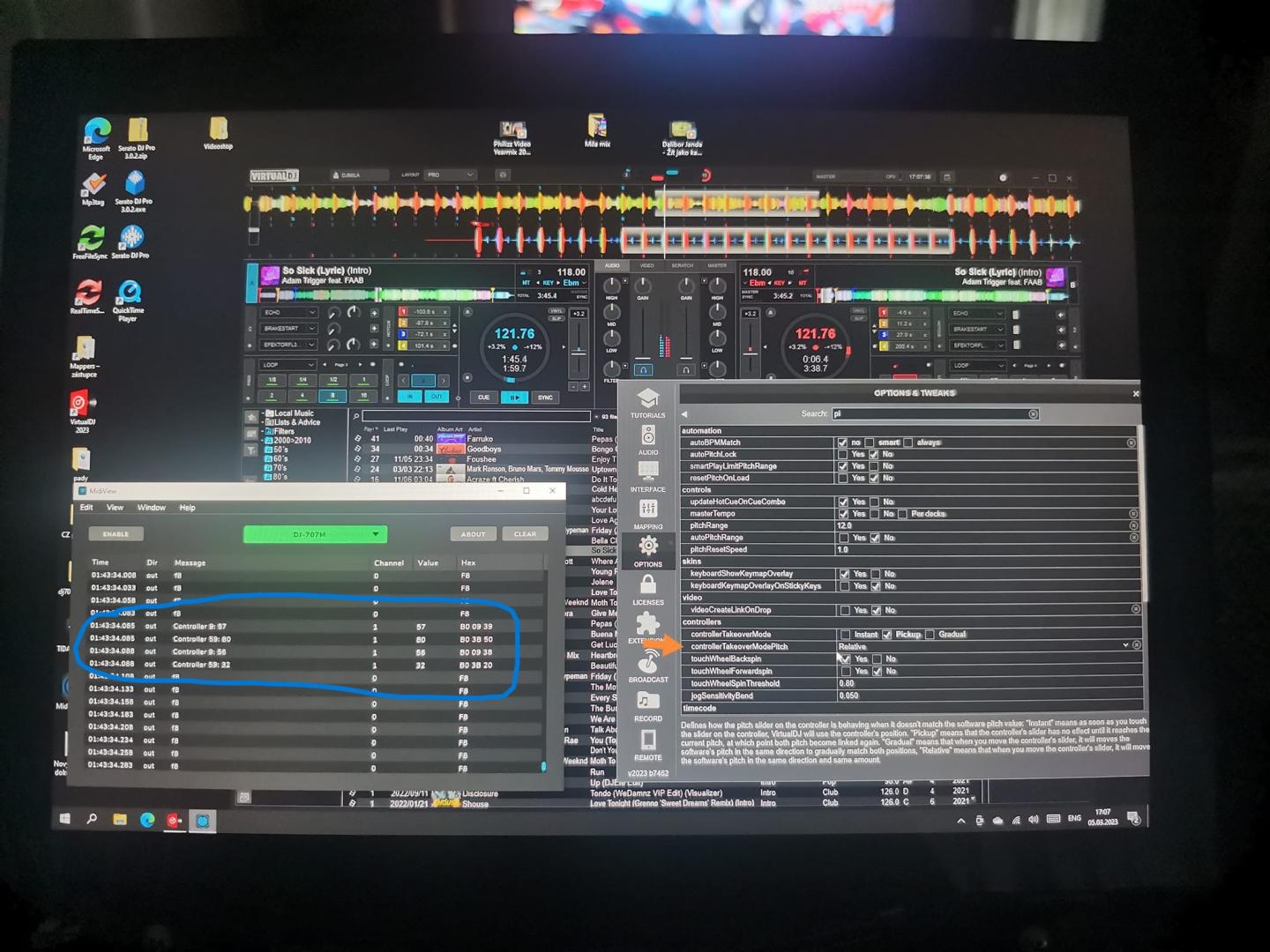

-Problem with pitch fader on 707m And Sync -
This problem has a lot of people. It is a new machine (2 months) and the left side. (perhaps everyone has the left side).
This problem is caused by Roland. I don't know if it's the firmware or a faulty pitch fader. A little help exists for VDJ. You need to change the pitch mode to Relative.
Posted Tue 07 Mar 23 @ 4:54 pm
But what I don't understand:
why do I receive a midi command only when the player is playing but when it is stopped there are no midi commands.
It is always Controller command 9 and 59 with different values.
Do you have any idea?

Roland 707m and Virtual DJ -jumping Pitch fader - SOLUTION !!!
1.) Menu Roland - Factoy Reset ALL ( system+Scene bank)
2.) Download latest firmware 1.04 and Install . ( flash the firmware even if you already have the latest 1.04 installed)
3.) New settings your scene -Not install from Backup .
The bugs are gone.. You can test with MidiView (when it doesn't send random midi information without VDJ and sends it with VDJ on, it's a software bug and can be fixed that way.
Posted Sun 12 Mar 23 @ 3:14 pm
THIS IN FACT SOLVES THE PROBLEM! I HAD INSTALLED THE FIRMWARE 1.04 INDEED, SO I JUST RESET ALL THE FACTORY SETTINGS AND NOW IT WORKES FINE.
THANK YOU!!
THANK YOU!!
Posted Mon 13 Mar 23 @ 8:32 pm
