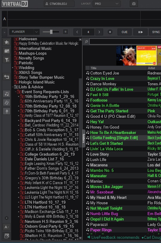

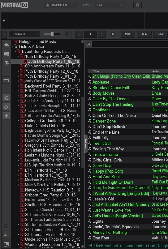

I'm having a problem dragging a virtual folder to the correct level inside the "Lists & Advice" folder. Whenever I drag it inside that folder, it wants to put it inside an existing subfolder; not just at the same level as all of the existing subfolders. I've tried it dozens of times trying to manipulate where it falls, but it won't recognize it as its own subfolder. Is something corrupted in that folder structure in the VDJ DB? I've attached some screen grabs of the folder [30th Birthday Party 1_05_19] I'm trying to move and an example of where it ends up.

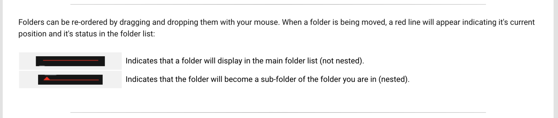

I used to struggle with this too. After doing some experiments I found that it depends on where your mouse pointer is at the moment when you drag and drop in the folder list. From the manual take note of the red lines;
Drag and drop has to be at the extreme left or right of the folder list at the moment of release. If you carefully watch the red line while dragging and holding the mouse pointer, moving it left or right, it will change from a straight red line to a straight red line with a triangle on it as above.

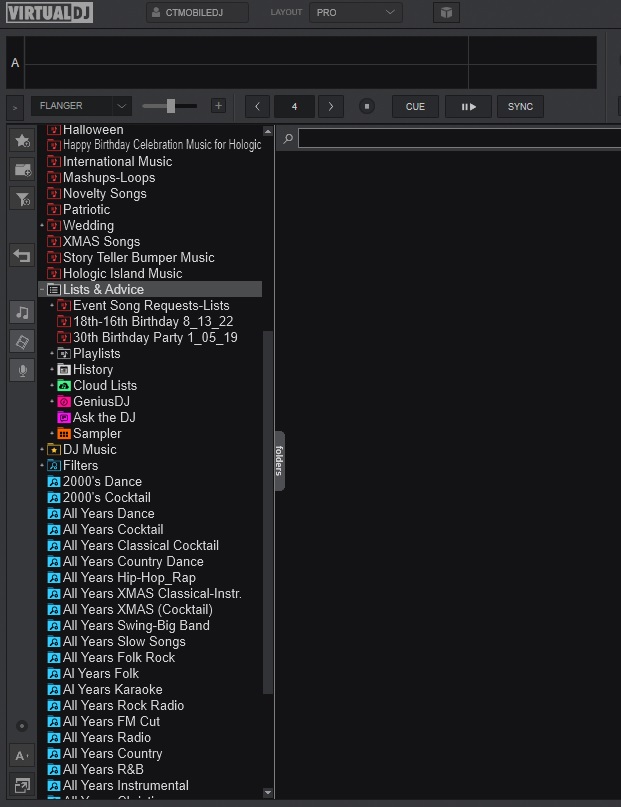

Thanks, guys (especially IIDEEJAYII) to confirm that it is a known bug in VDJ. It also explains how my current list of subfolders got where they are; they were created inside my top level "Event Songs Requests-Lists" folder to begin with and did not need dragging in. I was going crazy figuring this out - if there were existing subfolders present, why couldn't I just drag in a new one!!?? So, in the future, I need to make sure I am in the correct top level virtual folder when I make a new virtual sub-folder (wow - good to know).
I have to say it is very difficult to get it right.

Ohhhhhh! I was struggling with this too. Thank you for this 👍
Thanks to your advice, I managed to move my folder on the same level as the other folder in my tree by putting the mouse on the right (because on the left, it would have been nested).
This is so counter-intuitive !!! 🤯
(Yes, I should have RTFM for sure... But a good UI should be as intuitive as possible., shouldn't it?)
