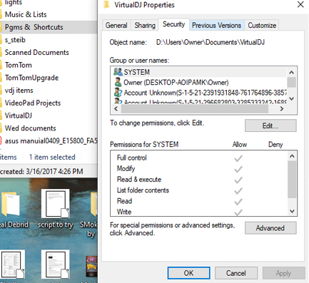

Your screenshot shows that the folder is read only for some reason, so that probably explains why vdj can't access the database
Posted Sat 06 Aug 22 @ 6:15 pm
Just changed it and it still shows,"unable to create database backup"
Posted Sat 06 Aug 22 @ 6:27 pm
bogart wrote :
Changed it previously. Just changed it again and it still shows,"unable to create database backup"Why won;t it accept changes
Posted Sat 06 Aug 22 @ 6:30 pm

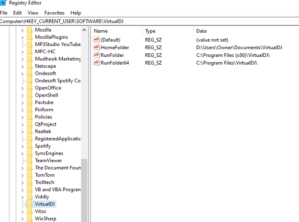

Unless you specifically tell the registry otherways, VDJ should have it's home folder on C drive documents folder.
Maybe worth checking. I have my home folder on D but all my backups work fine, even on build 7059
[HKEY_CURRENT_USER\Software\VirtualDJ]
"HomeFolder"="D:\\VirtualDJ"
You can set where the VDJ folder is there. Unless you have a specific use case it should be in the dicuments>virtualDJ folder on C drive

@KRADCLIFFE:
D drive is:
C Drive:
Registry
D drive is:
C Drive:
Registry
Posted Sun 07 Aug 22 @ 9:28 pm
Probably best to find your proper Virtualdj home folder and move it to the C > users > documents folder and update the registry accordingly.
Posted Sun 07 Aug 22 @ 11:22 pm
