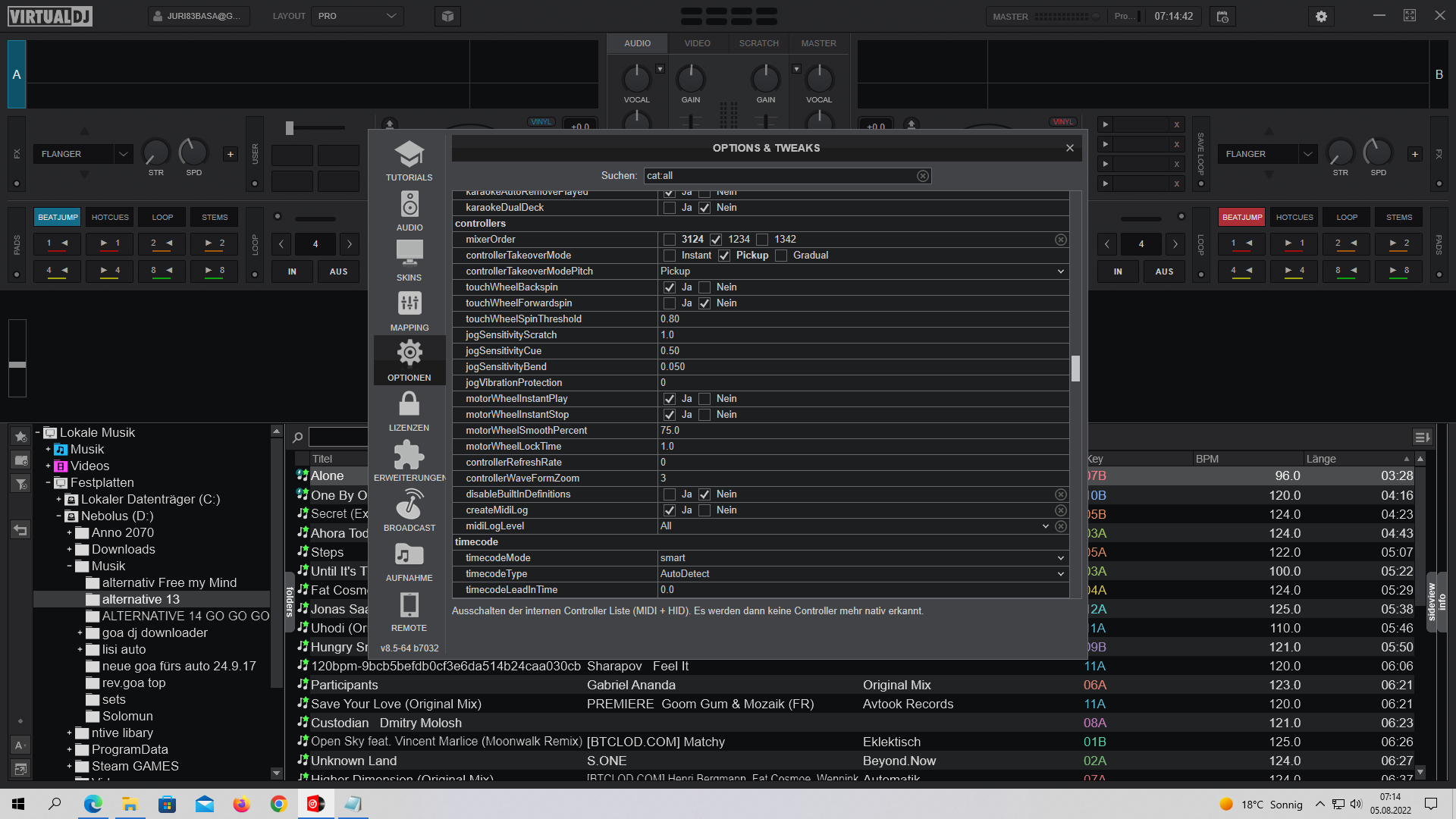

- Open VDJ, goto Settings->OPTIONS and enable (set to Yes) createMidiLog setting
- Close VDJ, make sure the MFT is properly connected and open VDj again.
- Close VDJ again.
- Post here the content of the generated file Log Rport.txt you will find in /Documents/VirtualDJ folder

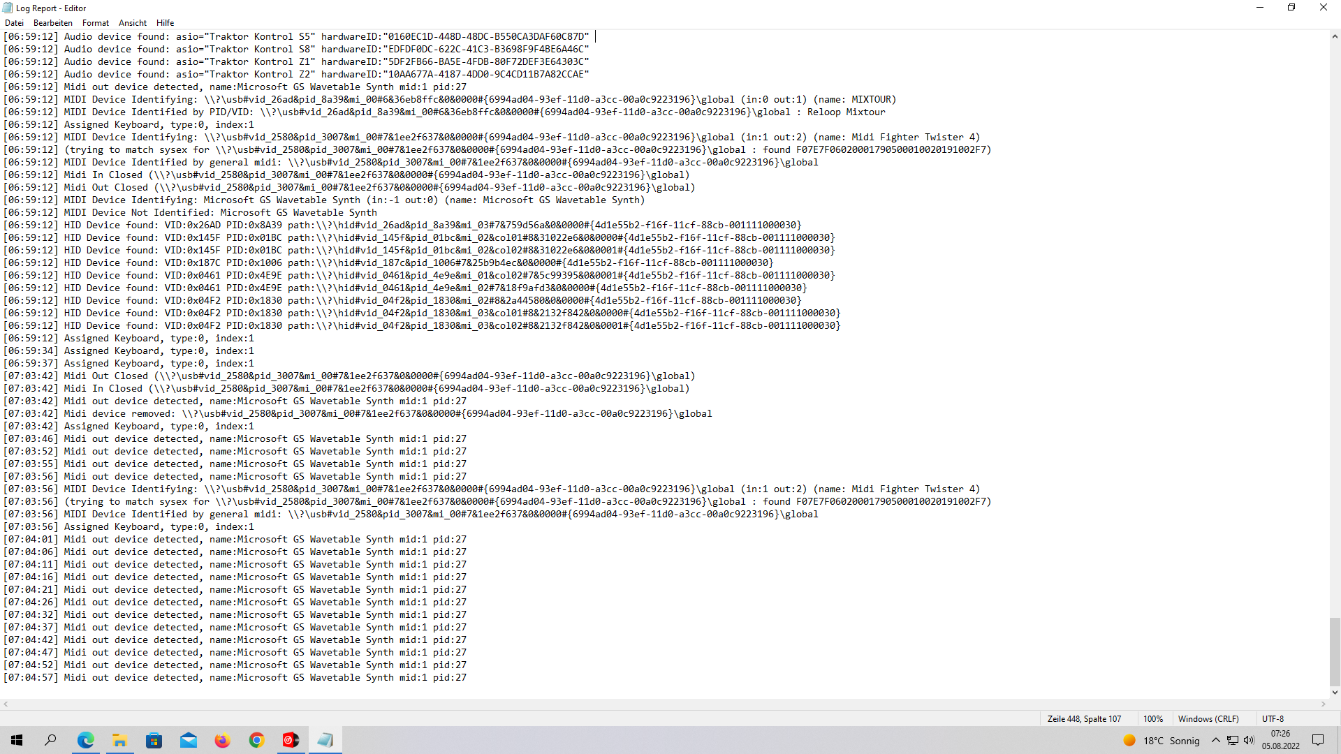

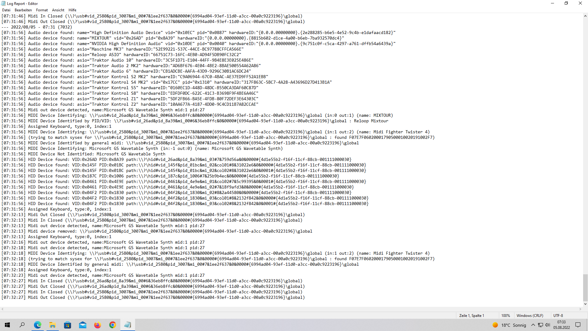

Thank you for helping me, I did all your instructions.
the dj software doesn't recognize it. Midi Fighter works with other software

For some reason, your Midi Fighter Twister has incorrect PID.
The factory values are ..vid="0x2580" pid="0x0007" while yours has ... pid="0x3007"
Not sure how this happened, not aware of any way to change the products USB VID/PID, so you will need to contact DJTechTools and explain the issue, in case they have a way to correct this.
If for any case, they say that it's some other version of the same model (like some MKII version) that we need to support, please ask them to contact us.
