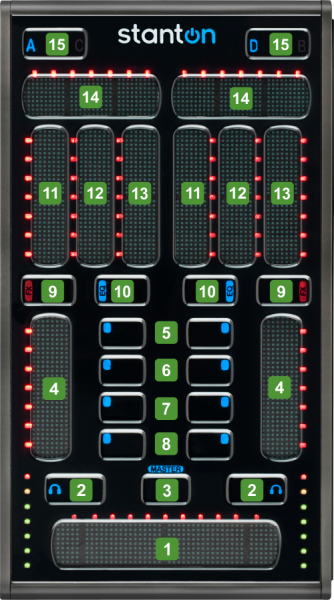

I have my EQ mode set to stems, how could I get my 6 Eq slider (3 per channel) to control the 5 stems, Ie. Channel A 1st Eq slider control the playing deck Hihat stem, Channel A 2nd Eq slider control the playing deck Instru stem, Channel A 3rd Eq slider control the playing deck Vocal stem, Channel B 1st Eq slider control the playing deck Bass stem, Channel B 2nd Eq slider control the playing deck Kick stem. I would like the script command for my Stanton SCS.3m controller.

Sure, have a look at the "stem" script in the mapper

Still trying to do this,
, how would i make button 11, 12, 13 on A side Stem volume Hihat, Instrument, Vocal, and button 11, 12, 13 B side stem volume Kick, Bass ?.

The device_side is the script command that did the trick.
