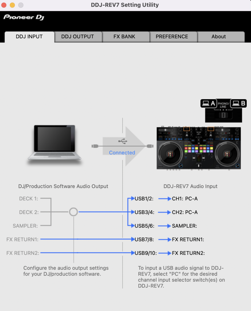

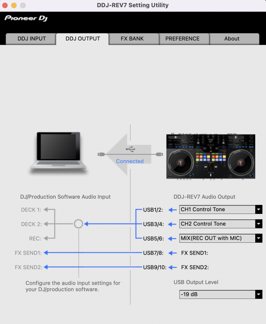

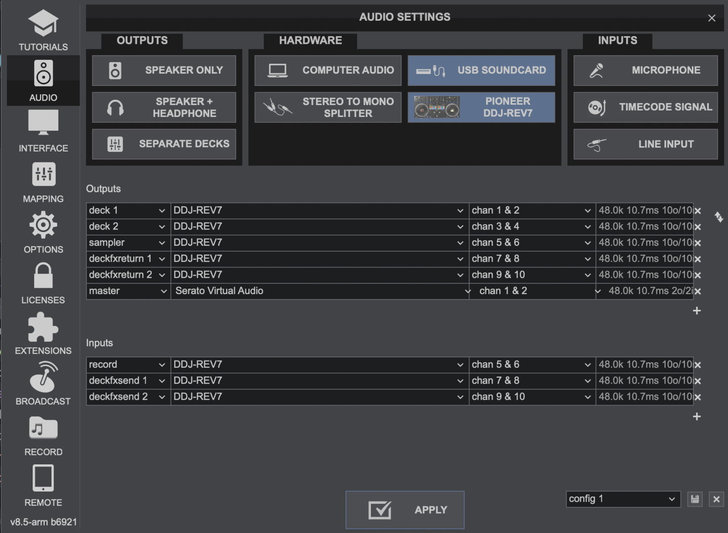

I've confirmed that USB 5/6 is routed to Mix out, and I've tried clicking on record as well as a broadcast and OBS is still not picking up the audio when I select DDJ-Rev7 as the source.
I want to maintain OBS as I have overlays and other things pertaining to streaming on Twitch.
The closest I get to having it work, is adding a "master" output to Serato Virtual Audio, and pointing OBS to pickup from that source. But, the problem is that FX, mic, sample, and instant scratch functions don't route through.
It seems like it's a routing issue, but I can't seem to find a combination of inputs and outputs to work.
ddj-rev7 settings:
ddj-rev7 settings:

Perhaps OBS IS picking the audio, but the audio it's too low for OBS ?
Try to change USB output level (headroom) on Pionner REV7 Utility panel from -19db to something higher. I don't remember by heart what values are offered but try something like -6db maybe ?

ohhh good one with the mic input/security/privacy... unfortunately though both VDJ and OBS is checked to see mic input.
Also great catch with the USB output possibly being too low, I tried setting it to the max (-5db) and unfortunately it's still a no go
As for a virtual cable, do you mean like a virtual I/O device? If so, I have immersed, MMaudio, and Serato Virtual Audio all installed (and working properly in their own use). And while all of these will pickup audio in OBS if I set a master output in VDJ to any one of them.... the FX, sampler, and mic doesn't get picked up. It's as if VDJ treats "master" differently with the ddj-rev7. The same thing happens if I choose booth.

I actually thought it was a pioneer issue.... but the following facts counter that idea:
- everything works fine with my RANE ONE (VDJ & OBS)
- Everything works fine when I run the rev7 with Serato (select Serato Virtual Audio in OBS)
- OBS never had the option to select specific USB channels with any of my previous controllers
There's something with the way VDJ routes the I/O with my rev7 that's preventing it from working 100%.
For instance, routing "master" out to whatever I choose, should actually do that. Instead, it leaves out FX, mic, sampler, etc... That tells me that VDJ is routing something different, leaving those other things out of the "master" mix. If when running it through Serato, I experience the same thing... then I would totally be looking at Pioneer. I don't think OBS is at fault because it's just listening to whatever input I tell it to listen to.
I believe the problem is with how VDJ is routing the I/O on the rev7, which is more complex than my Rane one.

You could use auxin and auxout to route the record input from vdj to the virtual audio cable.
Instead of the record input, write 'auxin' in the input selection box, then instead of 'master' write 'auxout' to the output to the virtual audio cable.
