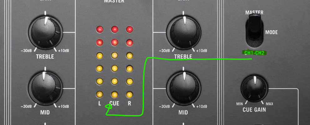

If you dont see this EQ led "bleed" in VirtualDJ (while using the setup with ndx500 and mixer), but only see this in hardware at the mixer itself, it sound a lot like the issue is at the mixer itself.
Either wiring (that you connected the audio in cable at back wrong, but seems unlikely...) or that the mixer itself bleeds audio (or if its just "cosmetic" at the channel leds, and not actual audio bleeding, it could just be the mixer is "broken" at the led parts..)

Actually checking the mixer, maybe its just "cosmetic" because the LEDs on this mixer seems a bit confusing perhaps ;-) You dont actually hear audio at other channel right? Its just the led in center between the EQs that show that way
the L + R led, is for the master output.
and the CUE led is for both ch1 and ch2 as cue decks (headphones)
"Monitors the audio level of the mix (L&R) and the pre-fader audio
levels of Channels 1 and 2 (CUE). "

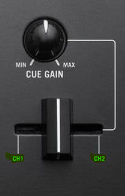

To select what channel to hear in the headphones, AND what channel display at the led at the mixer, use the headphone (cue) fader...
In other words, when that fader is at CH1, the led should show that channel only and vice versa.
And if set in between it will show both decks.

It has nothing to do with cue which has its on led (the one in the center). There is nothing wrong with the mixer either. I did another test to clear all the doubts. I plugged only one NDX to the mixer and the mixer EQ shows only one channel playing. That proves that there is no audio bleeding in the mixer.
As I wrote earlier, when I put the fader down of the other channel to do the mixing, I can feel a big audio cut which means I guess that the audio was on both channels.

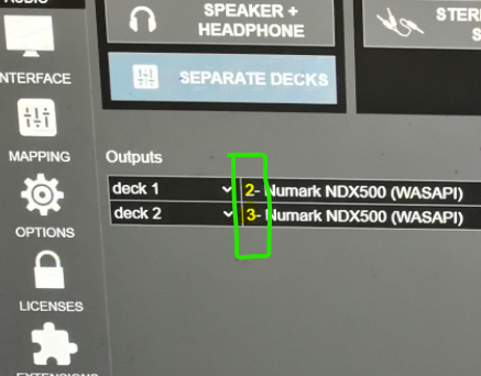

So, by reading over all again. . Could you post a screenshot of your audio settings in VirtualDJ.
And at the drop down where you select sound card, make sure you have NDX500 1 (at deck 1) and NDX500 2 (at deck 2 outout) . You said you had so at first post.

I meant the screenshot of VirtualDJ audio settings.
And make sure you have selected different NDX 500, one for each deck in VirtualD (use the drop down to see available sound cards for VirtualDJ in sound settings)
(but you said you had done this, in first post, but just to make sure.. cause doing this wrong would explain a lot..)

hmm seems ok.. Really unsure now..
you dont use the software crossfader right? you mix entirely at the mixer?
Not that it would cause what you experience.
And is there a #1 Numark NDX 500 ? (just to make sure #2 and #3 is not actually the same player)
(but if that was the case, then the opposite deck in VirtualDJ should produce no sound)

2 and 3 is because I plugged NDX into another USB port and vdj generated an additional ndx. I am sure they are different as NDX has a button called program by which you can switch tracks. The ones available on the first NDX are 1 and 3 and on the second NDX I have 2 and 4 therefore they are definitely different.
